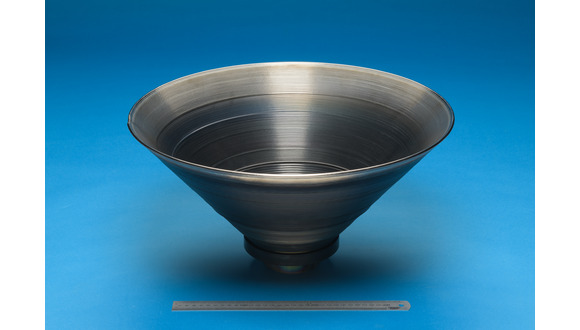

A 460mm x 190mm titanium frustum of a cone with a wall thickness of 4.5mm was manufactured with less than 2.5 hours of continuous build time. This has the potential to speed up the production of additive manufacturing using the novel coaxial electron beam directed energy deposition wire (DED/w) system from xBeam.

A frustum of a cone has been built using 3mm Ti-6Al-4V wire from Perrymans Inc. using the xBeam system. This was built to demonstrate the capability of the xBeam system, which has already shown that it has the potential to produce refined 𝛽-grain structures as reported by Davis et al. 2021.

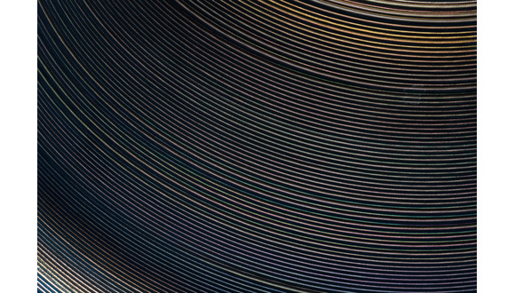

Images are of the frustum of a cone in the ‘as built’ condition.
