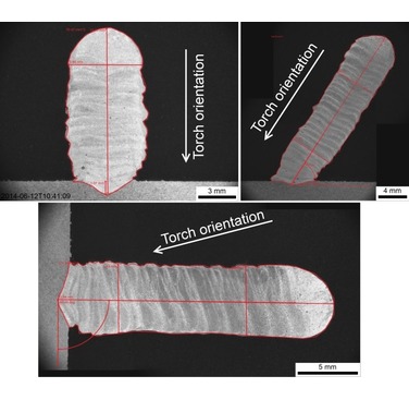

Test structures were created using the CMT process through the use of multipass welds with either a vertical or a horizontal offset. The experimental trials showed that structures could be produced with a range of orientations by varying the torch angle in line with the desired orientation. Figure 3 shows an example of the range of orientations achieved by building up on a horizontal substrate. All of these different orientations were produced with similar deposition rates.

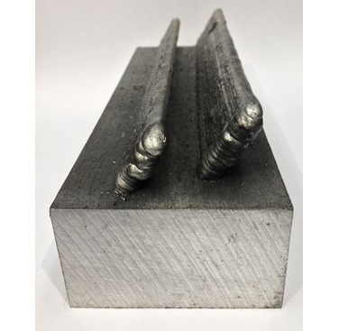

The technique was shown to be capable of producing good quality deposits that are free of porosity, with good inter-layer fusion and an impressive regularity when performed even at an angle (Figure 4). This research showed that the technique had great potential for the production of structures made from expensive or difficult to machine materials such as nickel or titanium alloys.

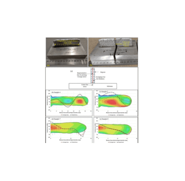

- Residual Stresses in Wire Arc Additively Manufactured Parts
Our experts worked alongside those from Coventry University on a study funded by the Lloyd’s Register Foundation to investigate residual stresses in wire arc additively manufactured (WAAM) aluminium alloy samples. This work formed part of the PhD work of TWI senior arc welding engineer, Karan Derekar, who was a student at the time of the project. The research led to the creation of a paper on the subject, titled, ‘Effects of Process Variants on Residual Stresses in Wire Arc Additive Manufacturing of Aluminium Alloy 5183,’ which discussed the effects of processing conditions on residual stress formation and distribution. The research highlighted that the base plate thickness and deposit height play a vital part in residual stress distribution, whilst the temperature of deposit (interlayer temperature) has an effect on the magnitude of residual stresses. Residual stresses were found to be lower with a higher interlayer temperature (figure 6). The samples for the study were manufactured at TWI using the pulsed metal inert gas (MIG) processes applied robotically. The residual stress measurements, using the contour method and computational approach, were conducted at Coventry University while experts from TWI, Coventry University, and the University of North Texas all provided input to the study.

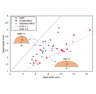

- Integrated AM from Feedstock to Part Quality: WAAM Process to Achieve Consistent Bead Geometry with Conventional Feedstock Composition
Despite the high deposition rates and large build envelope, arc additive manufacturing can sometimes suffer from unfavourable deposition conditions as a result of the complex thermal characteristics, the use of conventional welding wire, and fixed process inputs. This can lead to inconsistencies in the deposited bead geometry and microstructure that, in turn, create excessive scatter in mechanical properties, which hinders part qualification and limits the use of WAAM parts in safety critical applications.
This project sought to develop a fundamental understanding of process factors that influence deposition conditions, as well as devising monitoring and analysis techniques to assess surface quality and dimensional accuracy in order to improve the robustness of the WAAM process. Our experts worked to identify critical deposition parameters that control weld bead geometry and microstructure for a variety of build geometries while also adapting conventional NDT techniques to monitor WAAM deposition, from which key information can be extracted for feedback control (figure 7). The outcomes showed that WAAM process was stable for carbon steel using commercially available synergic line and control methods. Further, physical samples and measurements were generated and used to develop an understanding of process factors that influence deposition conditions. A vision camera melt pool imaging and python-based analysis and monitoring method was also developed (figure 8).

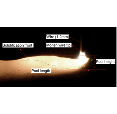

- Integrated AM from Feedstock to Part Quality: Development of an in-situ monitoring technique for the detection of flaws in WAAM depositions
The complexity of the WAAM process means that deviations from optimal deposition parameters, random changes in environmental conditions, feed rate and energy input may lead to the formation of flaws. In addition, different equipment, feedstock quality variations, and working conditions can obstruct the final quality of a build. In such cases, the late detection of unacceptable flaws may lead to unnecessary rework or, even worse, render a build or a batch into scrap. To address these challenges for the benefit of industry, we launched a core research project to develop in-situ ultrasonic inspection during the build process.
The study demonstrated that in-situ ultrasonic inspection is possible and effective in detecting flaws and changes in component growth during the WAAM manufacturing process. This trial was an important milestone to pave the way for further research and advancements in in-situ monitoring and inspection of WAAM depositions.

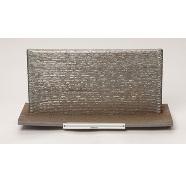

Figure 1: Completed full scale wall made with parallel bead deposition profile

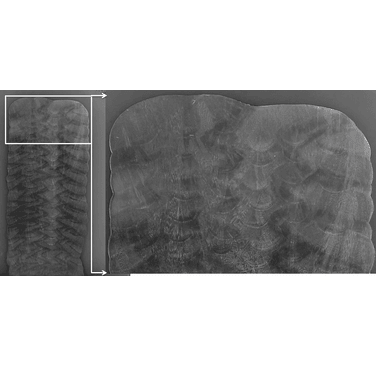

Figure 2: Vertical cross section of Alloy 625 alloy wall built using parallel bead deposition method
Figure 3: Range of produced orientations achievable by the CMT process
Figure 4: Example of weld beads produced with a 60 degree angle

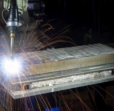

Figure 5: Work begins on a trial test block
Figure 6: Residual stress measurements in WAAM aluminium alloy samples
Figure 7: Plot of bead height vs bead width
Figure 8: Melt pool image from Xiris welding camera
