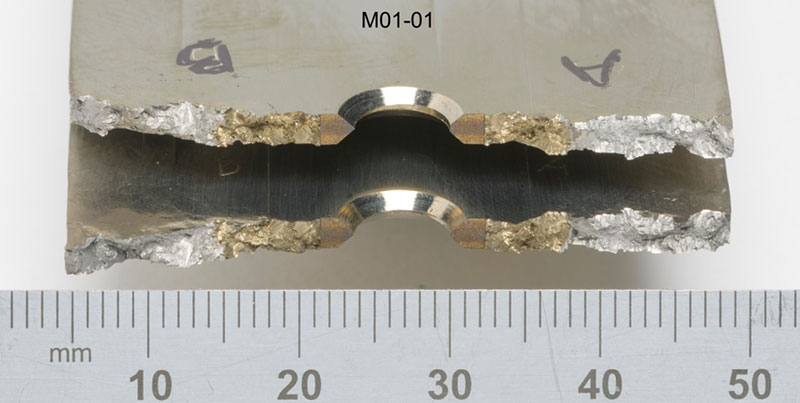

Figure 6: Cast Ti-6Al-4V Alloy FSW - Fracture toughness testing
