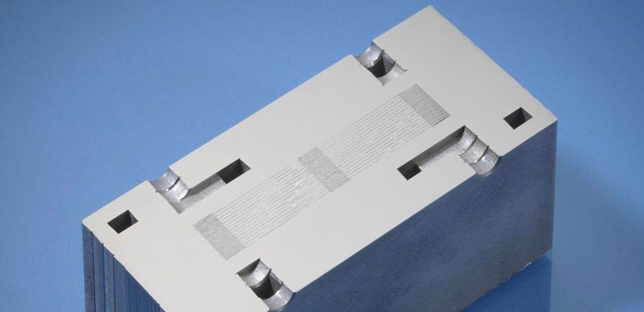

TWI joined a project funded by and for the European Space Agency to develop compact lightweight micro-channel heat exchangers (MCHX) for reusable launch systems.
