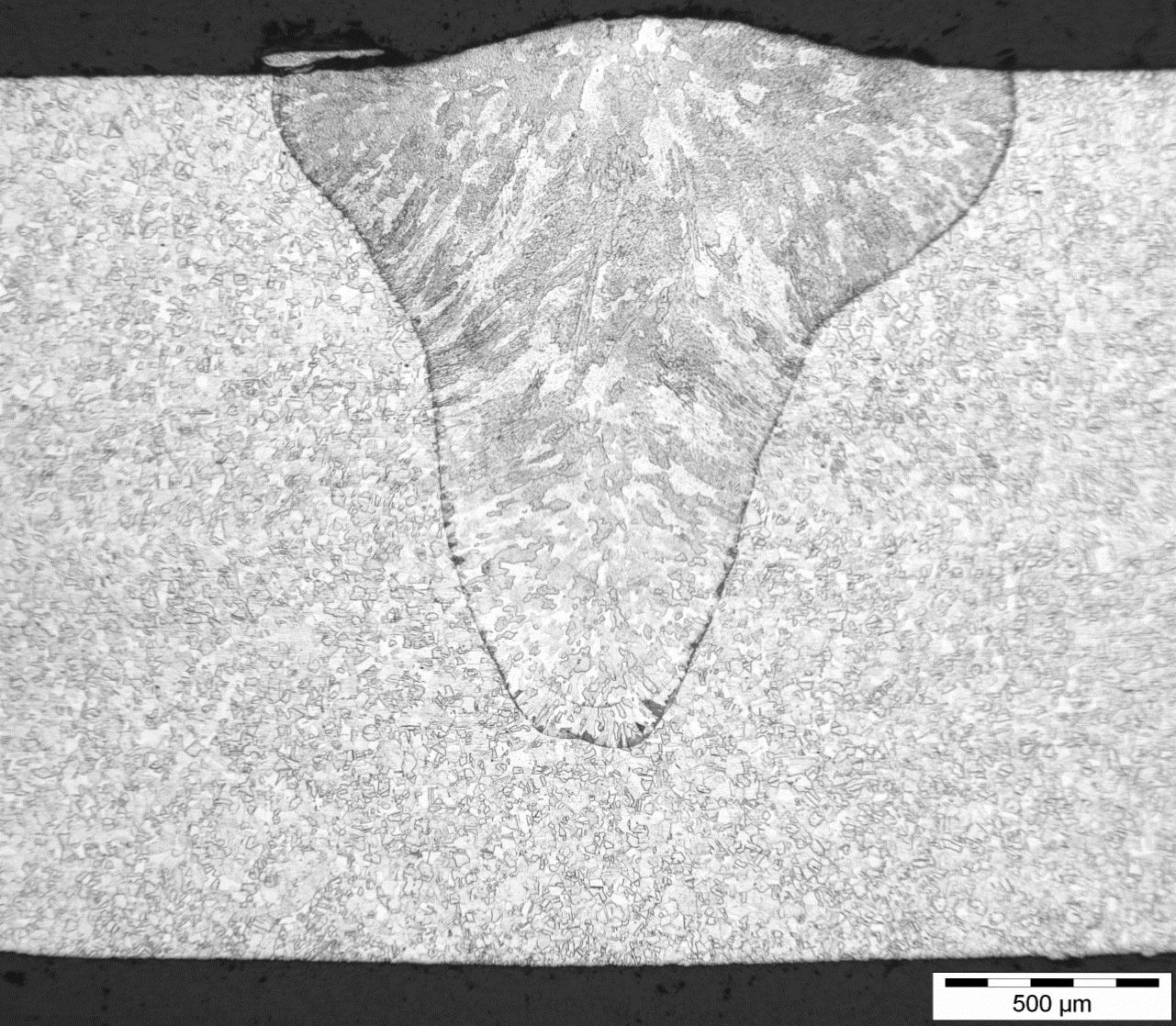

Parameters are being developed to compare the results of laser and electron beam welding.  Preliminary melt run trials in each material, followed by butt welds in both heterogeneous and dissimilar material combinations, have already taken place.
Results of these trials are now being evaluated through a combination of visual inspection, X-ray radiographic inspection (using both conventional and microfocus X-ray techniques), scanning acoustic microscopy, destructive sectioning, hardness surveying and electron microscopy, to confirm that stable, acceptable conditions have been established. The quality of the welds is being assessed to the aerospace standard DIN 29595:2007-04 ‘Welding in aerospace – Fusion welded metallic components – Requirements’.
Figure 2:1. Titanium EB weld
Figure 2:2. 17-7PH stainless steel pulsed QCW fibre laser weld
Figure 2:3. 347 stainless steel EB weld
Figure 2:4. 347 stainless steel CW fibre laser butt weld
Figure 2:5. 347 stainless steel pulsed QCW fibre laser butt weld
Figure 2: EB and laser welding trials have been undertaken on the agreed materials of interest to achieve specific weld penetration depths and qualities. Images 1–5 (not all to same scale) show example results.
