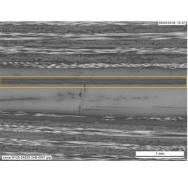

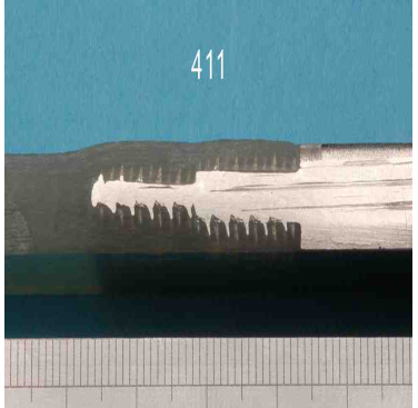

- Linear Friction Welding of Carbon Fibre Reinforced Plastic
TWI investigated the use of linear friction welding (LFW) to join continuous fibre carbon reinforced PEEK (Polyetheretherketone) thermoplastic composite (CFRTPC). Fibre degradation was mitigated against thorough the addition of an unreinforced PEEK interlayer that was critical in increasing join strength from 17MPa (Figure 1) to match that of an adhesively bonded joint without the need for surface pre-treatment. The research found that the most successful parameters for the CFRTPC joint were 50Hz, ±1.0mm, 40MPa, while the PEEK interlayer showed adequate heat generation with non-degraded polymer forged out of the joint. Visual assessment from PEEK welding suggests that applying LFW to CFRTPCs using current metal welding equipment at TWI had the potential to effectively produce welded joints. The welded coupons achieved an apparent lap shear strength of 25.4MPa without any surface preparation.

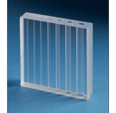

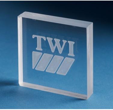

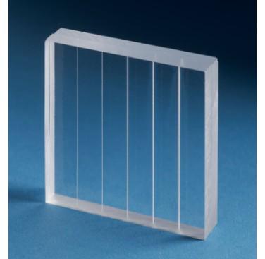

- Diffusion Bonding of Polymer Based Micro- and Nano-fluidic Devices
Used in industries such as clinical chemistry, medical, life sciences, biotech and more, microfluidic devices (also known as plastic manifolds, bonded plastic manifolds, plastic pneumatic manifolds, plastic air boards, plastic valve manifolds, plastic medical manifolds and plastic flowcells) are comprised of a series of micro-scale channels. This project was created with the aim of developing process parameters and then to manufacture a defect-free and transparent diffusion bonded micro-channelled thermoplastic demonstrator. Our experts were able to produce demonstrators from both polymethyl methacrylate (PMMA) and polycarbonate (PC), showing that diffusion bonding with laser channelling was a candidate for manufacturing the next generation of microfluidic devices (Figures 2-4).

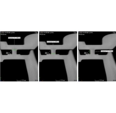

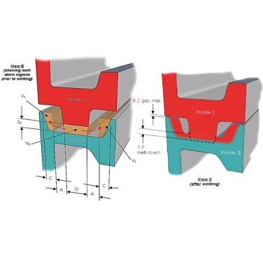

- Failure Investigation of Welded Moulded Plastic Components
Our close working relationship with a number of automakers and Tier 1 suppliers of major automotive companies has given us an awareness of the challenges around the welding of moulded plastic components. These components offer a number of advantages to the industry, but the weld quality remains dependent on the material and joint design for the specific welding process, making verification of weld quality a challenging task. To help address this we undertook an assessment of the weld integrity of a moulded plastic component by destructive and non-destructive examination (Figure 5). The component, a vapour separator made from Hostaform® C13031 (POM), was welded using linear vibration welding (LVW) before verification of the weld quality by visual inspection and microtoming and, although there were already tell-tale signs of poor weld (Figures 6a, 6b, 6c), computed tomography (CT) scans, which provided the most revealing flaws that were indicative of poor welding procedures (Figures 7-9). As a further outcome from this work, TWI developed a three-day training course and assessment, including practical demonstrations, to improve understanding of material selection, design and fabrication of moulded plastic components as well as helping to set up and develop a new British Standard, BS 89100; Joining of thermoplastic moulded components.

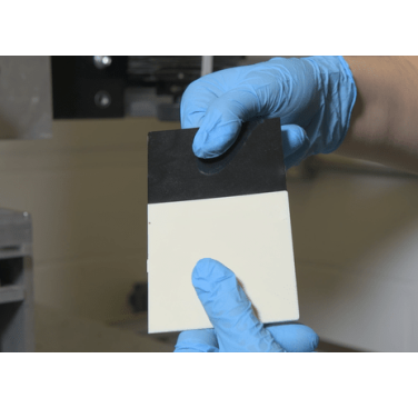

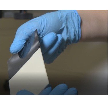

- Metal to Composite Joining Breaches a New Frontier
Another breakthrough at TWI was the creation of a technique for composite to metal joining that uses metal surface pre-treatment that allows the polyester resin and glass fibre composite to bond to it. Sculpting the surface of the metal into small peaks and troughs creates a prepared area for the polyester resin to run into to create the join, although some applications may require a further adhesive layer. These ‘Comeld’ joints fail at a much higher loads and absorb far more energy before failure than a conventional joint of identical dimensions (Figures 10-11).

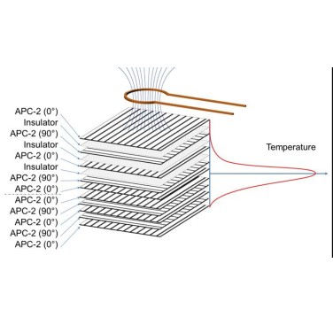

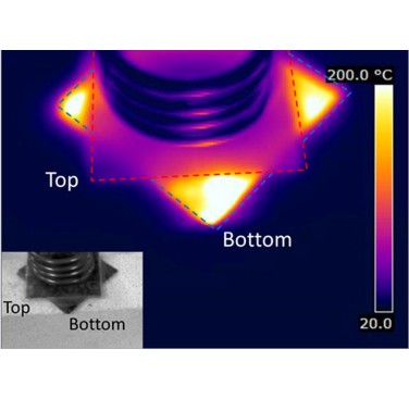

- A New Approach to Thermoplastic Composite Induction Welding
TWI invented a new method for induction heating composites containing carbon fibres that generated sufficient heat to be used for adhesive curing or fusion bonding. The technique exploits the electrical conductivity of carbon fibres in the composite parts and is capable of concentrating the heat around the joint interface, rather than close to the top surface of the composite where the proximity of the induction coil is greatest. This prevents the problem of needing to remove excess heat from the surface of the composite to avoid thermal damage and provides greater control over the process. Results of the temperature rise show that, despite being closer to the source of the electromagnetic radiation, the top laminate experienced a much smaller temperature rise than the bottom laminate (Figures 12-13).

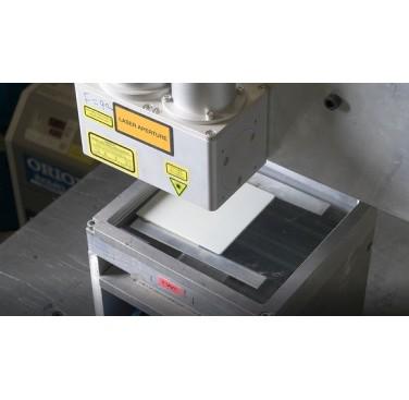

- Real-Time Temperature Monitoring for Polymer Welding
Our expert teams also addressed the challenge of using laser welding to join difficult-to-weld polymers through thermal management and the control of interface temperatures. We used a Hamamatsu LD-Heater to monitor the interface temperature while transmission laser welding three materials; polybutylene terephthalate (PBT), polyphenylene sulphide (PPS) and thermoplastic elastomers (TPE). This allowed us to develop a welding procedure specification for transmission laser welding of PBT, PPS and TPE following the production of demonstration coupon samples (Figures 14-16). As well ensuring fine temperature control and the identification of any defects, we were able to deliver demonstrable benefits in terms of productivity, reduction in reject rates and cost/time savings over other joining methods such as ultrasonic, hot plate or adhesives.

Figure 1. Sacrificial PEEK interlayer between two carbon/PEEK laminates. Yellow lines denote weld location
Figure 2. Diffusion bonded polycarbonate (PC)
Figure 3. Diffusion bonded polymethyl methacrylate (PMMA) with laser processed channels
Figure 4. Diffusion bonded polycarbonate (PC) with precision machined channels

Figure 8. Scrutinising weld dimensions of a tongue and groove welded vapour separator by CT
Figure 9. Scrutinising weld dimensions of a tongue and groove welded vapour separator against the design rule
Figure 10. Pretreated metal with surface alterations, prepared for composite joining
Figure 11. Completed 'Comeld' joint
Figure 12. Thermal image of induction heating with insulating gauze (top) and without (bottom)
Figure 13. Temperature peak is focused at the weld interface
Figure 14. Overhead view of polybutylene terephthalate (PBT) coupon held under pressure, underneath laser welding head
