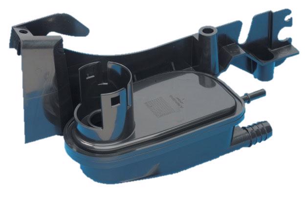

A vapour separator, made of Hostaform® C13031 (POM), see Figure 1, was welded using linear vibration welding (LVW). This is one of the most widely used welding techniques for thermoplastics for under the bonnet applications.

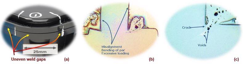

Verification of weld quality was done by visual inspection and microtoming and, although there were tell-tale signs of poor weld (Figures 2a, 2b, 2c), computed tomography (CT) scans provided the most revealing flaws.

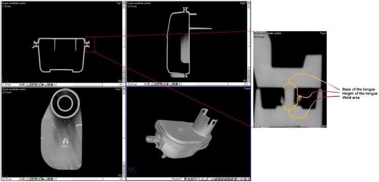

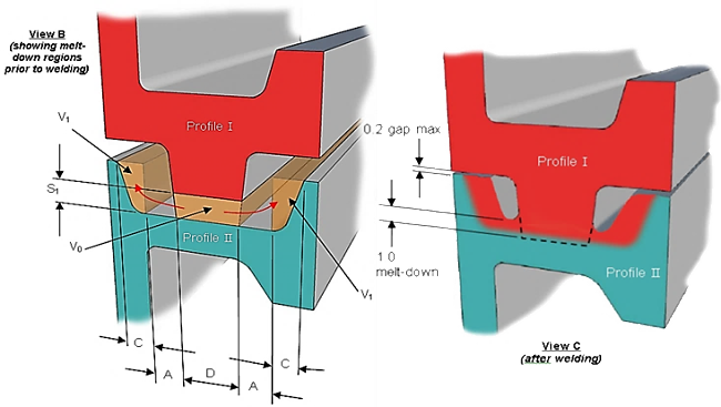

Design rules for welding dictate critical dimensions, which should be adhered to if a good weld is to be expected. In most investigations there is no access to the welded locations of the component, therefore their quality cannot directly be compared to the design rules.

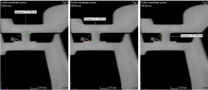

Non-destructive qualitative assessment of the welded joint was carried out using an X-Tek HMXCT 225 X-ray Micro-focus machine. Computed Tomography (CT) images and videos were obtained and scrutinised. The information obtained was indicative of poor welding procedures, Figures 3-5.
Figure 1. Welded vapour separator
Figure 2. Showing welding quality issues: a) Poor weld gap across part's perimeter; b) Excessive uneven loading of the part; c) Voids and cracks at the foot of the weld

Figure 4. Scrutinising weld dimensions of a tongue and groove welded vapour separator by CT
Figure 5. Scrutinising weld dimensions of a tongue and groove welded vapour separator against the design rule

CT proved to be an impressive tool, which provides a non-destructive scrutiny of welded parts. It enables direct comparison against design rules and helped to identify:
  • Non-uniform weld flash around the perimeter of the weld.
  • The weld-flash and the weld-gauge of the tongue and groove joint were inconsistent.
  • The weld dimensions and gauge of the tongue and groove joint did not pass the criteria set by the automotive company’s design rules.
