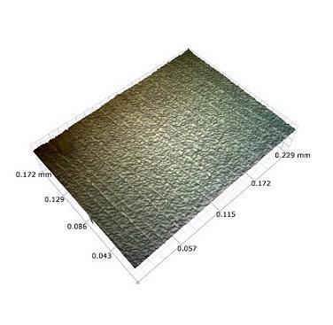

- Environmental Performance of Carbon Fibre Composites
The EU-funded MODCOMP project explored new and innovative ways to modify and enhance carbon fibre composite structures. Our expertise was called upon due to our experience in the characterisation and testing of materials and surfaces. As carbon fibre use spread across industry it became important to understand how it reacts to its environment, particularly with respect to changes in physical properties and the strength of any final composite structure. The MODCOMP project assessed the impact of UV/humidity on composite performance. This was achieved by measuring the structural and surface degradation performance of composite material during exposure to a cyclic weathering test incorporating periods of UV exposure (8 hours UV-A, 60°C), followed by periods of condensation/humidity (4 hours , 50°C). The tested materials were then assessed using surface analysis methods including optical microscopy, scanning electron microscopy, and white light interferometry (Figures 4, 5a and 5b). Following this, there were mechanical tests to determine the effect of any degradation experienced upon physical properties.

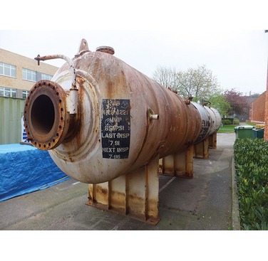

Figure 1: Benchmark vessel used for detailed examinations and testing

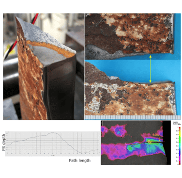

Figure 2: From top left, fracture faces of a specimen extracted from a corroded brace after testing in air. Map of the corroded surface. Line profile from the map showing the geometry

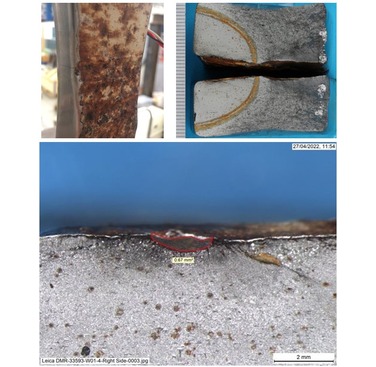

Figure 3: From top left, fracture faces of a specimen extracted from a corroded brace after testing in air. Map of the corroded surface. Line profile from the map showing the geometry

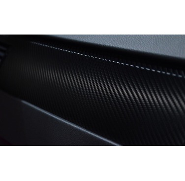

Figure 4: MODCOMP project composite
Figure 5a: White Light Interferometry of carbon fibre composite before accelerated weathering

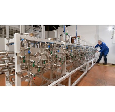

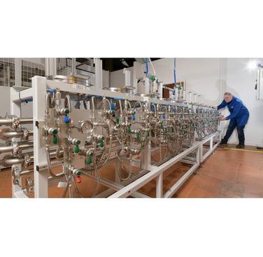

Figure 6: Hydrogen service testing rig
