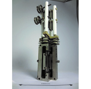

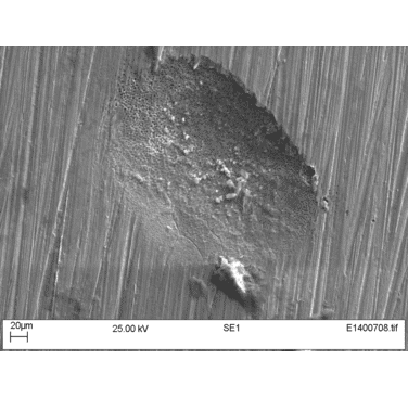

TWI conducted a series of tests to thoroughly assess the effect of dilution on the performance of a corrosion-resistant weld overlay (Figures 1 and 2). Dilution in weld overlay procedures tends to be controlled by restricting the heat input, but because this can be achieved by proportionally varying both the welding current and the welding speed, the resulting dilution can be different, even if the heat input is controlled. This has led to industry taking a conservative approach when specifying the permissible levels of dilution, resulting in productivity losses, cost increases, and associated issues such as distortion of components.
Our experts explored TIG, MIG and tandem MIG welding procedures to establish exactly how the weld overlay integrity is affected when the iron content exceeds five per cent, exploring the effects of a range of dilution levels – up to 50 per cent – on carbon steel substrate. The weld overlays were subjected to a comprehensive range of corrosion and corrosion fatigue tests to establish their performance. The testing confirmed that Alloy 625 could sustain a significantly higher iron content without any significant loss of corrosion or corrosion fatigue performance. These results should provide more confidence in relaxing the current dilution restrictions, potentially resulting in significant cost savings.

Figure 1: A specimen assembly used for pitting/crevice and stress corrosion cracking testing

Figure 2: Micrograph of a seawater crevice corrosion tested sample
