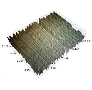

Figure 1a. White Light Interferometry of carbon fibre composite before accelerated weathering

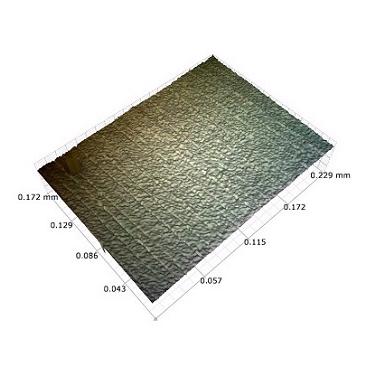

Figure 1b. White Light Interferometry of carbon fibre composite after 1000 hours accelerated weathering
