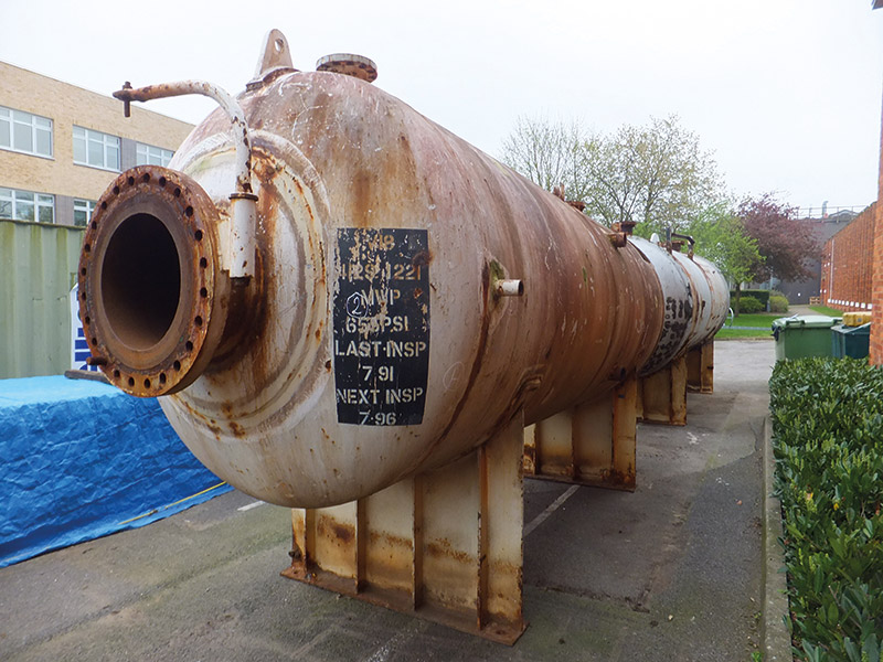

The member company removed one of the vessels from service after processing was diverted to a different platform. TWI carried out detailed examinations and testing on this vessel to investigate the in-service degradation, manufacturing quality and material properties. Both non-destructive and destructive examinations were conducted at fatigue-critical locations and areas of high corrosion. The examinations revealed an overall good manufacturing quality, with low levels of in-service degradation and no evidence of fatigue cracking.

Benchmark vessel used for detailed examinations and testing
