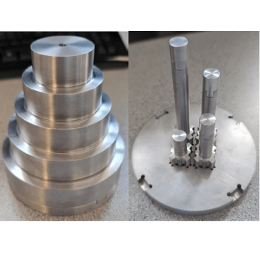

- Development of a Standard Reference Geometry for XCT

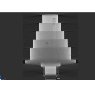

The team at our facility in Port Talbot, Wales designed and manufactured a standard reference geometry for use with X-ray computed tomography (XCT) for the European Space Agency (ESA). At the time of the project there were limited standard reference geometries for use within XCT, so the aim was to allow for image quality to be verified based upon a series of criteria and constraints, informed by a literature review. Taking account of the literature review findings, and the requirements from ESA, the potential geometries were subjected to a set of weighted evaluation criteria, which resulted in the final design (Figure 1). The final design was based around a step cylinder comprised of aluminium, with removable internal cylindrical pins that are raised within the part to represent different penetrable thicknesses. To assess the image quality, micrometre scale line features were placed in a circular pattern around the removable pins along with hemispherical patterns to represent porosity. Figure 2 shows an XCT image of the manufactured step cylinder.

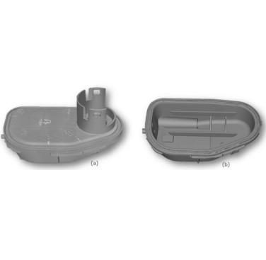

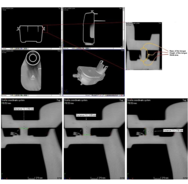

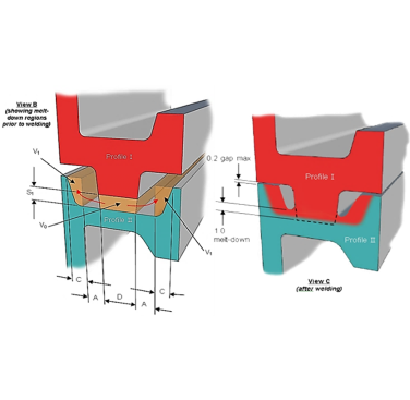

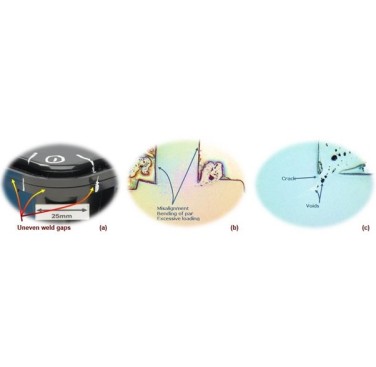

- Failure Investigation of Welded Moulded Plastic Components

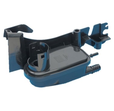

TWI used CT to support automotive industry goals to identify and develop new materials and processes to drive powertrain efficiency. With lightweighting in parts requiring the replacement of conventional metals with lighter polymers and hybrid materials, engine components require the use of advanced engineering thermoplastic materials that are moulded into complex 3D structures and then joined together. The quality of the finished parts is reliant on both the material and the joint design for specific welding processes. Verifying the weld quality had been an ongoing challenge for both manufacturers and suppliers, which was borne out by premature in-service failures being reported by automakers.
To help provide confidence in welded moulded plastic components for the automotive industry, our experts undertook an assessment of destructive and non-destructive examination methods for weld integrity. Tests were conducted on a vapour separator (Figure 3), that had been welded using linear vibration welding (LVW). This is one of the most widely used welding techniques for thermoplastics for under-the-bonnet applications. Inspection showed tell-tale signs of poor weld (Figures 4a, 4b, 4c), with the computed tomography (CT) scans providing the most revealing flaws. This was despite the component passing general QA tests and burst tests.
CT images and videos were able to show evidence of poor welding procedures (Figures 5-7), even where there was no access to the welded locations of the component, so that their quality could not be directly compared to the design rules. While the research showed that all current investigative techniques, (e.g. visual inspection, microtoming and burst test) remained valid, CT was able to identify issues including non-uniform weld flash around the perimeter of the weld, and inconsistencies between the weld-flash and the weld-gauge of the tongue and groove joint, which did not pass the criteria set by the automotive company’s design rules.

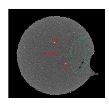

- Additive Reinforced Friction Stir Welds

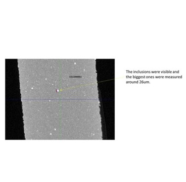

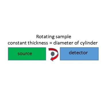

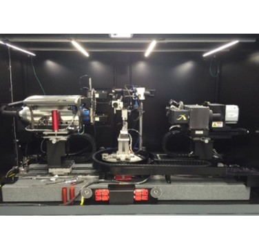

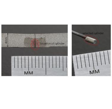

Although CT is a non-destructive testing (NDT) technique, there have been instances when TWI has used it within a destructive testing framework. One such project applied X-ray microscope tomography to characterise the homogeneity of friction stir welds that had been reinforced using additive nanoparticles. Silicon carbide particles had been added to two 4mm aluminium plates prior to friction stir welding. A sample was then prepared by cutting off a cylinder from the FSW specimen in order to allow a fine enough resolution for the detection of very small features and to equalise the X-ray penetration through the sample (thickness= constant diameter). The cut off sample can be seen in Figure 9, and the position of the sample in relation to the source and the detector in Figure 10. Because the sample had been cut, the computed tomography cannot be classified as an NDT technique.
The results (such as those shown in Figures 11-12) demonstrated the capability of X-ray microscope tomography to show particles against the aluminium alloy base in 3D as well as the detection of voids in the weld, with the X-ray microscope tomography system having the potential to locate particles down to 1μm.

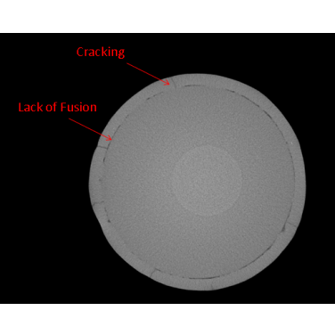

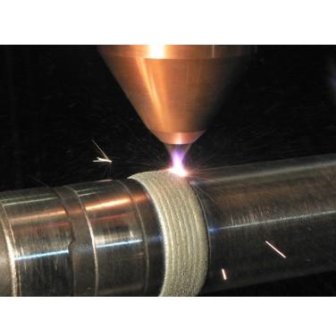

- Refurbishment of Railway Axles

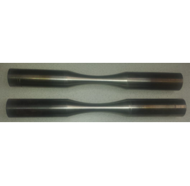

Our experts combined CT with expertise in laser cladding to test a potential solution to high levels of potentially unnecessary scrappage in the rail industry. Strict safety regulations led to high scrappage rates for railway axles that had suffered even minor wear or corrosion. To address this this costly material wastage, TWI joined an industry consortium for the ReLASE project, which aimed to develop a cost-effective and highly durable coating-based method for repairing worn railway axles. Laser cladding (Figure 13) was investigated as a solution for repair the of axle wheel seat areas. Coupon samples (Figure 14) were produced with a range of coating compositions that could then be compared using XCT imagery (Figures 15-16) to assess coating quality, defect characterisation and down-selection of coupons for fatigue testing. The results of the testing informed the development of an equivalent, but more portable, ultrasonic inspection technique as well as allowing for the optimisation of the coating process for the selected powders to minimise defects such as cracking, voiding, porosity, and lack of fusion. Additional fatigue testing compared the mechanical performance of cladded coupons with coupons of parent material. The project used both non-destructive and destructive testing methods to demonstrate the successful application of laser-engineered coatings to rail axles as a means of cost-effective refurbishment.

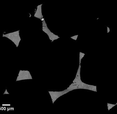

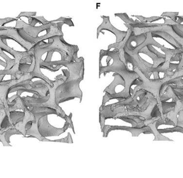

- Digital Volume Correlation (DVC) Analysis of Aluminium Foam
https://www.twi-global.com/media-and-events/insights/digital-volume-correlation-dvc-analysis-of-aluminium-foam
Cellular materials such as cork, bamboo and sponge are widespread in nature. Their unique combination of properties have led them to be replicated with synthetic cellular materials using polymers, metals, glasses, ceramics and carbon with the aim of mimicking their behaviour. These multifunctional materials promise low weight, low thermal conductivity, high specific surface area, ability to undergo large deformations at relatively low and constant stresses without rebounding, making them particularly attractive for lightweight structures, fluid flow control, porous electrodes, energy absorption, thermal insulation, acoustic damping, and vibration damping.
XCT has been shown as a successful method for performing NDT on materials containing cellular structures for the qualitative and quantitative inspection of components and intricate structures with 3D characterisation. Previous studies had used XCT to investigate aluminium (AI) foam, providing information on cross-section shape, cell size, and ligament area distribution. However, these studies only investigated the foam in an undeformed state. TWI addressed this gap by creating a project using XCT and digital volume correlation (DVC) to assess AI foam behaviour under mechanical or thermal load.

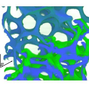

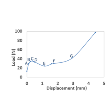

TWI used water jet cutting to form a cylindrical specimen of AI open-cell foam that was then subjected to quasi-static compression. The compression was interrupted at intervals (Figure 17) so that the specimen, which was held at compressive load, could be examined with XCT. The

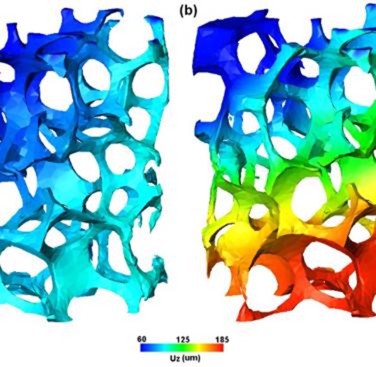

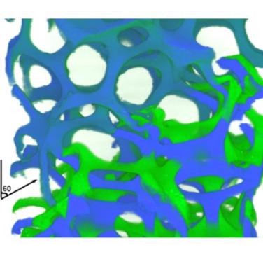

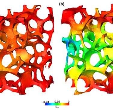

Acquired datasets were analysed to identify damage micro-mechanisms, and to perform a digital volume correlation (DVC) study using both local digital volume correlation analysis (LADVC) and global digital volume correlation analysis (GADVC).
XCT was able to provide information about cell wall microstructure, including the presence of microscopic features such as foreign particles, precipitates and of micro-pores (Figure 18). Such features could lead to a non-homogeneous stress/strain distribution. Figures 19-23 show the 3D rendering of the Al foam during the in-situ compression experiments, which revealed four main stages of material behaviour. This study exploited the use of complementary methods, including time-lapse imaging by XCT, in-situ experiments and DVC analyses to provide insights into Al foam behaviour when subjected to compression. The same approach can be used to study different cellular structures.

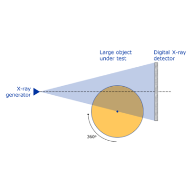

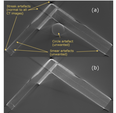

- Development of Offset X-Ray Computed Tomography Inspection
TWI’s work with CT not only assists industry with general and specific challenges but also involves advancing the process itself. One such core research programme (CRP) project addressed the limitation of XCT where the size of component that it can handle is restricted by the field of view of the digital X-ray detector.
TWI developed offset CT as a technique that allows larger components to be inspected, thereby extending the capabilities of existing equipment. Larger components referred to those objects whose width, even at the lowest magnification, does not fit within the field of view of the digital detector. Before this research, offset CT had been used in academia, but only to a limited extent by industry. TWI’s work developed sufficient understanding of the process to implement and deploy the inspection method.
Figure 1. Final design
Figure 2. XCT image of the manufactured step cylinder
Figure 3. Welded vapour separator
Figure 4. Showing welding quality issues: a) Poor weld gap across part's perimeter; b) Excessive uneven loading of the part; c) Voids and cracks at the foot of the weld

 Figure 6. Scrutinising weld dimensions of a tongue and groove welded vapour separator by CT
Figure 7. Scrutinising weld dimensions of a tongue and groove welded vapour separator against the design rule
Figure 8. X-ray microscope tomography system at TWI
Figure 9. Cylindrical sample for X-ray microscope tomography
Figure 10. Schematic cylinder sample between source of X-rays and detector
Figure 11. Part of XZ cross section with seen particles
Figure 12. XY cross section with seen particles and voids
Figure 13. Laser-cladding process
Figure 14. Coupons selected for evaluation of cladding quality and consistency

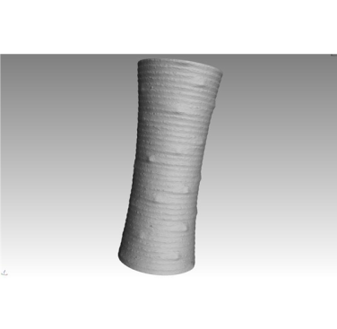

Figure 15. XCT slice of coupon
Figure 16. XCT 3D volume of coupon sample
Figure 17. Compressive response for the Al open-cell foam. Experimental observations are represented by dots, while the curve is obtained by interpolation of the experimental data. Incremental stages refer to a displacement of: 0.12 mm (A), 1.14 mm (E), 1.74 mm (F), and 2.94 mm (G).
Figure 18. 2D cross-section perpendicular to the load direction of the Al open-cell foam in the undeformed condition
Figure 19. 3D rendering of the Al open-cell foam under compressive loading
Figure 20. Overlapped volumes for the displacement levels of 0.54 mm (in blue) and 1.14 mm (in green), correspondingly with point D and E in Figure 17 respectively
Figure 21. Axial displacement (uz) obtained by global DVC analysis for the magnitude displacement of 0.12 mm and 0.24 mm
Figure 22. Axial strain map (εzz) obtained by global DVC analysis for the magnitude displacement of 0.12 mm and 0.24 mm
Figure 23. Offset CT acquisition setup
Figure 24. Cross-section of a large polymer composite joint using data from an offset CT scan:
a) With no processing of X-ray images, showing artefacts due to the offset
b) After use of the tailing technique, showing removal of artefacts due to the offset
Figure 24. Cross-section of a large polymer composite joint using data from an offset CT scan: a) With no processing of X-ray images, showing artefacts due to the offset b) After use of the tailing technique, showing removal of artefacts due to the offset
