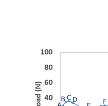

Figure 1. Compressive response for the Al open-cell foam. Experimental observations are represented by dots, while the curve is obtained by interpolation of the experimental data.

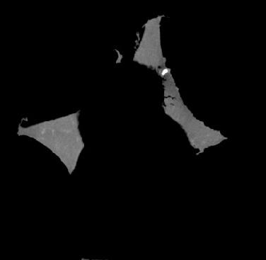

X-ray CT images provide information on the cell wall microstructure, which in turn depends on the manufacturing process. Non-homogeneous cell wall material microstructure can be revealed by virtually sliding across the full volume under investigation. In addition, the presence of microscopic features such as foreign particles, precipitates and of micro-pores can be detected (Figure 2).

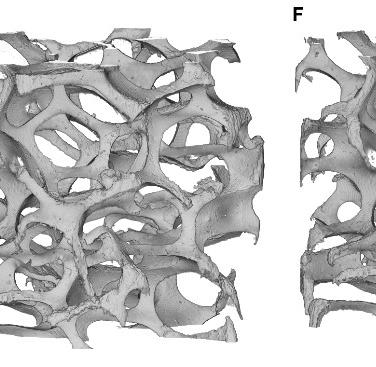

This is of particular importance because it might result in a non-homogeneous stress/strain distribution. Three-dimensional analysis is required for investigating cell morphology, spatial distribution of micro-pores and other features inside the cell walls. Figure 3 shows the 3D rendering of the Al foam during the in-situ compression experiment. Intermediate loading conditions considered are highlighted in the curve in Figure 1. The compressive load was applied upwards from the bottom sample end.
The in-situ results revealed four main stages in the material behaviour:
  • First stage, nearly linear regime in the load/displacement curve up to the peak load, characterised by relatively small translations along the loading direction up to the peak load. However, no relevant deformations were visible. The volume A in Figure 3 is representative of this stage.

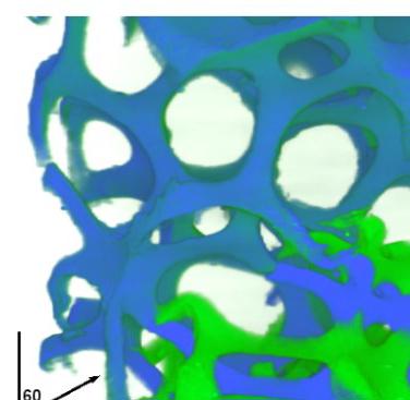

  • Second stage, the cell deformation and collapse start along an inclined band with respect to the load direction (at around 60˚) corresponding to the point D reported in Figure 1. The deformation band appears approximately at one third of the high of the specimen with respects to the loading and supporting end, as shown in Figure 4. The overlapping of the volumes between D and E (Figure 1), shows that displacements are mostly associated with the lower sub-volume defined by the deformation band, while the sub-volume on the top of the deformation band is matching, see Figure 4. The main deformation modes along the deformation band are bending and buckling.
  • Third stage, characterised by the plateau region. This represents a typical behaviour of Al foam structures, making them excellent candidates for energy absorption applications. Results showed that the volume does not undergo to large deformations during this stage, see comparison between volume E and F in Figure 3.
  • Fourth stage, associated with the steep increase of displacement (last regime of the curve in Figure 1). A correspondent increase of deformation with failure of the cell branches along the deformation band is observed, see volume F in Figure 3. The sub-volume in the upper side of the deformation band also starts exhibiting displacements, and the band of crushed cells spreads downwards defining the collapsing zone, see volume G in Figure 3.

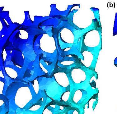

The displacement map associated with the first stage of the material behaviour, Figure 5, highlights:
  • The displacement vector field has an axial component (uz) but also a radial component
  • The foam structure exhibits different displacements from loading end to supporting end. In particular, higher displacements are associated with the loading end; see Figure 5(b).

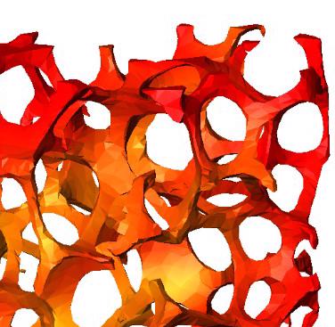

The volumetric strain map obtained applying a global DVC analysis for the first stage of the material behaviour is shown in Figure 6. Results highlight:
  • Almost uniform and very low strain corresponding to a displacement of 0.12 mm, Figure 6(a)
  • Gradient of strain distribution along the structure for the magnitude displacement of 0.24 mm, Figure 6(b). Specifically, loading and supporting ends do not show any strain changes respect to the previous loading stage, Figure 6(a); while the strain increases in the intermediate region of the structure. This provides an indication of the location of the deformation band and damage initiation.

Figure 2. 2D cross-section perpendicular to the load direction of the Al open-cell foam in the undeformed condition.
Figure 3. 3D rendering of the Al open-cell foam under compressive loading. With reference to the loading curve in Figure 1, incremental stages refer to a displacement of: 0.12 mm (A), 1.14 mm (E), 1.74 mm (F), and 2.94 mm (G).
Figure 4. Overlapped volumes for the displacement levels of 0.54 mm (in blue) and 1.14 mm (in green), correspondingly with point D and E in Figure 1 respectively.
Figure 5. Axial displacement (uz) obtained by global DVC analysis for the magnitude displacement of 0.12 mm (a), and 0.24 mm (b).
Figure 6. Axial strain map (εzz) obtained by global DVC analysis for the magnitude displacement of 0.12 mm (a), and 0.24 mm (b).
