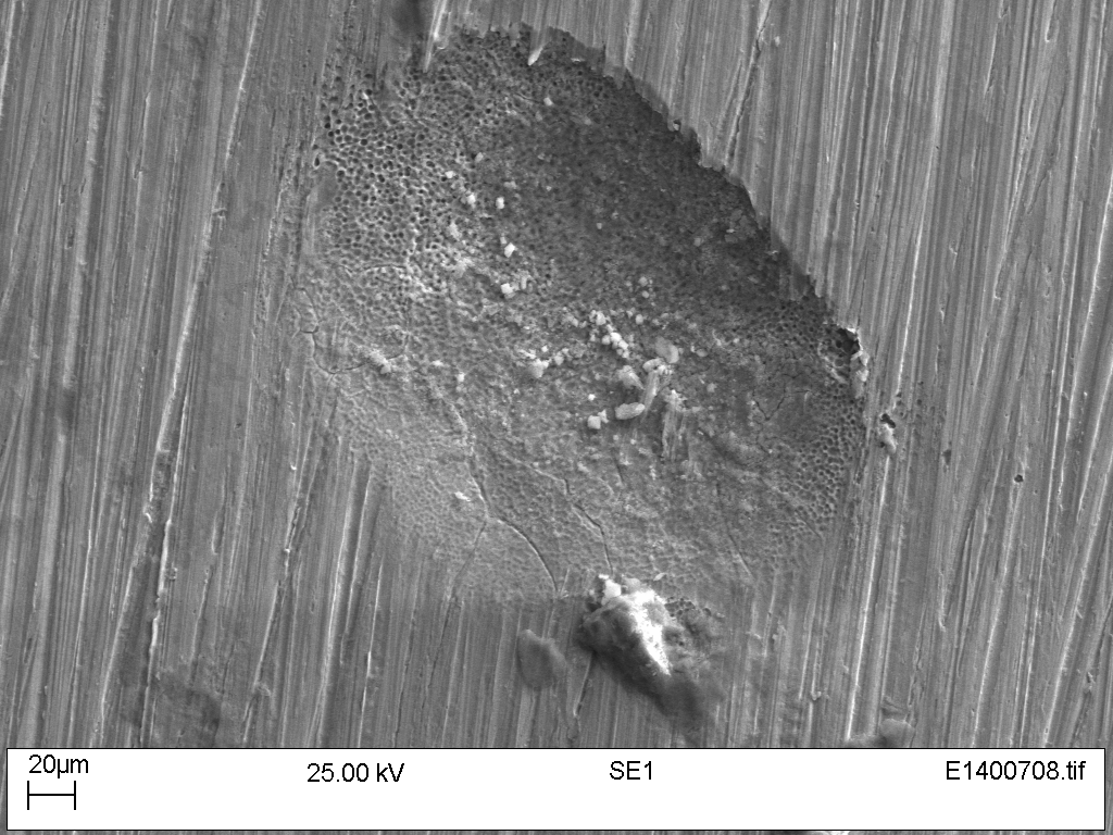

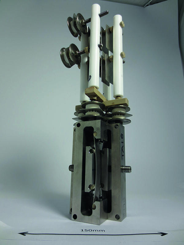

TWI launched a joint industry project to establish exactly how the weld overlay integrity is affected when the iron content exceeds five per cent, exploring the effects of a range of dilution levels – up to 50 per cent – on carbon steel substrate. Welding processes including TIG, MIG and tandem MIG were used. The weld overlays were subjected to a comprehensive range of corrosion and corrosion fatigue tests to establish their performance.
The testing confirmed that Alloy 625 could sustain a significantly higher iron content without any significant loss of corrosion or corrosion fatigue performance. These results should provide more confidence in relaxing the current dilution restrictions, potentially resulting in significant cost savings.

Figure 1 (a) Photographs of the specimen assemblies used for pitting/crevice and stress corrosion cracking testing; (b) micrograph of a seawater crevice corrosion tested sample
