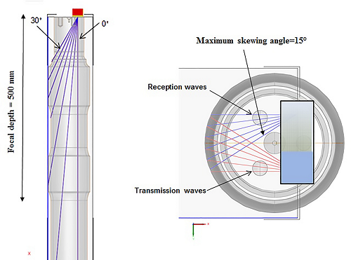

Phased array probe
The phased array probe must meet the following design requirements:
  • Adaptable to axle end face diameters from 110mm to 160mm
  • Operation in pulse-echo and pitch-catch mode
  • Provide beam steering and beam skewing capabilities.

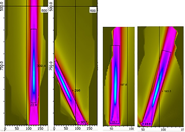

Figures 1 and 2 present the probe performance requirements as well as the beam performance achieved.

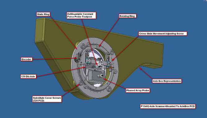

Inspection scanner
  • Mounted onto a wide range of axles and wheel bearing housings
  • Ability to position the probe to end face diameters from 110-165mm
  • Perform 360° encoded circumferential scan
  • Provide radial movement to position the phased array probe as required.
Figure 3 shows the design concept for the inspection scanner and its main parts.

The unique prototype phased array probe has met these requirements, providing:
  • excellent beam steering and skewing capabilities
  • coverage of the critical areas of the axle
  • improved detection capabilities.
The developed inspection solid axle scanner met the requirements for adaptability and can be used for:
  • inspection of dismantled wheel sets
  • inspection of fully assembled wheel sets.

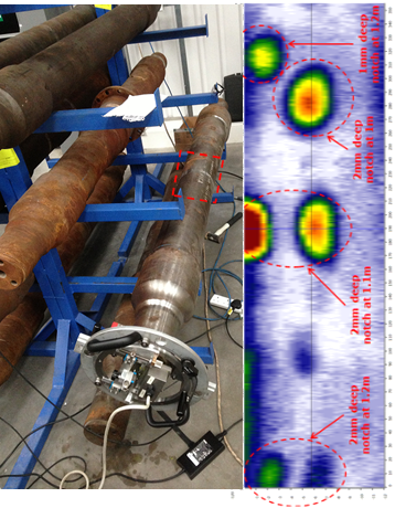

Figure 4 shows the scanner and the phased array probe mounted on a full length solid axle that artificial defects of various depths have been introduced at different distances from the end face.
Figure 4 also presents the phased array data acquired by system that demonstrates all the introduced defects have been detected with high accuracy.

Figure 1 Probe performance requirements
Figure 2 Beam performance from developed probe for (a) Steering (b) Skewing
Figure 3 Scanner design concept mounted on an axle box
Figure 4 Phased array data acquired by the developed inspection system during lab trials
