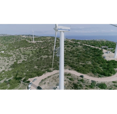

Figure 1: SheaRIOS WTB inspection at the CRES demonstration wind farm, Greece

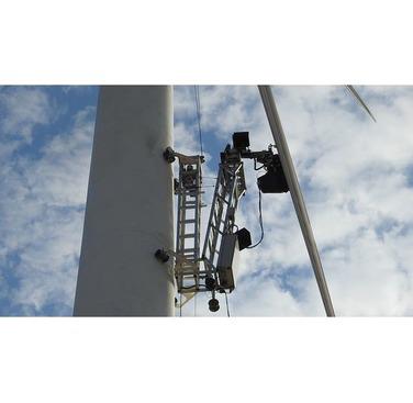

Figure 2: Deployment of the SheaRIOS project crawling robot with the on-board inspection system

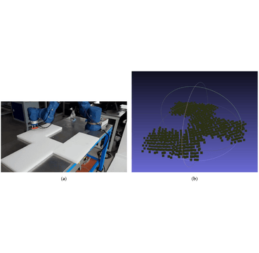

Figure 3: AI-assisted NDT Scanning of Unknown Geometries using Collaborative Robots - demonstration of CFSA

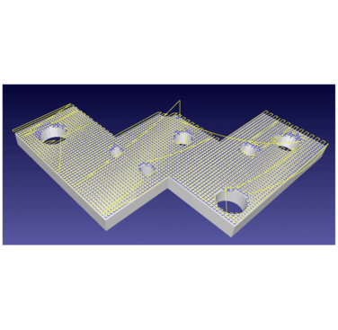

Figure 4:  AI-assisted NDT Scanning of Unknown Geometries using Collaborative Robots - demonstration of complex curvature with CFSA

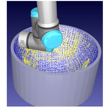

Figure 5: AI-assisted NDT Scanning of Unknown Geometries using Collaborative Robots - automatic online profiling and scanning of an object with non-smooth shape

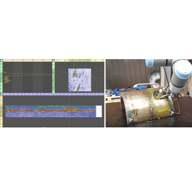

Figure 6: AI-assisted NDT Scanning of Unknown Geometries using Collaborative Robots - Half-pipe Inspection
