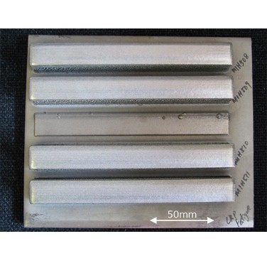

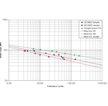

This CRP work was created to address the industrial need for performance data for laser metal deposited alloy 718, a well-established material that was widely used in aeroengine designs. The TWI team also sought to optimise process parameters on the basis of performance rather than in relation to metallurgical quality. To achieve this, we deposited rectangular blocks of alloy 718 on 316L stainless steel plates (Figure 1), before subjecting the samples to two-stage heat treatment. Wrought alloy 718 was also used to provide a benchmark for fatigue and tensile testing. Both high energy input (HEI) and low energy input (LEI) were investigated with a series of tests, including tensile tests in air under ambient and elevated temperatures (630°C) and fatigue testing in air under ambient conditions and creep rupture testing at 630°C (Figure 2).

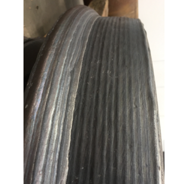

This UKRI-funded project aimed to develop a remanufacturing cell for rail wheels including in-process and post-production inspection to ensure accuracy and integrity of the wheels. This project addressed the cost of wheel replacements which, at the time of the project, typically involved either turning all of the wheels on a train to match the diameter of the most worn wheel or simply replacing the worn wheel. This project not only investigated cladding as an alternative repair strategy but also addressed the lack of industry standards for repaired wheels. The manufacturing cell was designed to be reconfigurable so that it could accommodate wheelsets of different diameters and software was written to control the automation of the welding process while also monitoring the weld current, weld speed, volts and wire feed speed (Figures 3-4). In-process inspection was undertaken with laser ultrasonic testing (LUT).

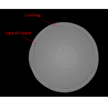

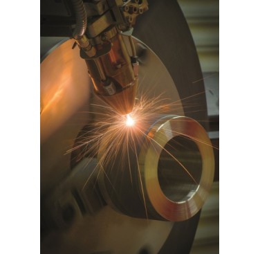

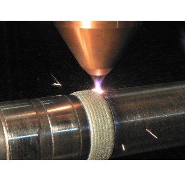

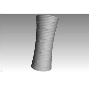

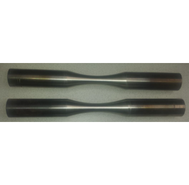

Also concerned with repair solutions for the rail industry, the ReLASE Project investigated the use of laser cladding to increase the service life of railway axles and reduce scrappage rates (Figure 5). Our experts worked alongside representatives from Tata Steel, LASE and Wall Colmonoy to provide a cladding solution that provided increased wear and fatigue resistance for the wheel-seat areas of axles. The project team not only produced laser-engineered coatings for the refurbishment of locomotive axles and other assets but also assessed the mechanical properties of the coated samples and developed a reliable means of inspecting various coatings. Wall Colmonoy produced powders of varying compositions from which LASE were able to produce coupon samples (Figure 6), before TWI carried out X-ray computed tomography (Figures 7-8) to assess the coating quality and defect characterisation and to down-select coupons for fatigue testing. By optimising the coating process of the selected powders, defects such as cracking, voiding, porosity and lack of fusion were minimised. The fatigue testing of the best coupons enabled the comparison of the mechanical performance of cladded coupons with coupons of parent material, showing that the laser cladding process offered a solution for the repair of railway axles.

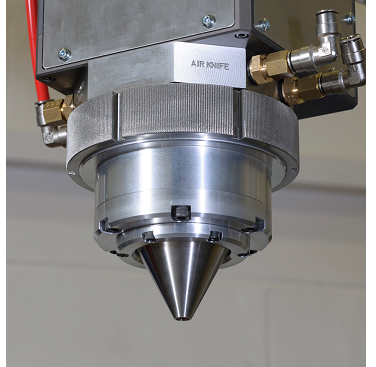

- ModuLase: Re-Configurable Laser Processing Head

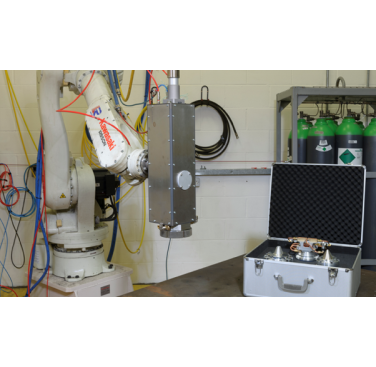

Funded by the European Union’s Horizon 2020 research and innovation programme, the ModuLase project was created to develop a reconfigurable laser processing head that is capable of performing welding, cutting and cladding processes (Figures 9-10) through the use of three modular end-effectors. Intelligent sensor technologies were also incorporated to provide in-process monitoring. The project team had to account for the different laser beam energy distributions, power densities, stand-off distances, Rayleigh lengths, gas, wire/powder feed requirements for each process. The development of the ModuLase system offered reduced capital investment costs, reduced downtimes and lower running costs compared to regular systems.

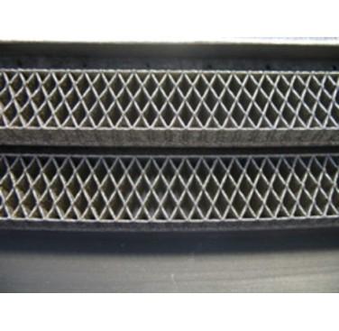

TWI’s experts worked with a leading aero engine manufacturer to develop laser cladding for the repair of blades and seal segments (Figure 11).

Figure 1. Test samples produced using HEI parameters
Figure 2. Fatigue test results

Figure 4. Remanufactured train wheel
Figure 5. Laser-cladding process

Figure 7. XCT slice of coupon
Figure 8. XCT 3D volume of coupon sample

Figure 10. ModuLase cladding end effector
Figure 11. Powder metal repair process
Figure 12. Shaft refurbishment using laser cladding
