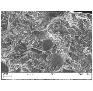

By 2018, interest in the hydrogen economy had uncovered a need to understand how to safely produce, store and transport hydrogen. Austenitic stainless steels had already shown a lower susceptibility to hydrogen embrittlement than ferritic steels, so TWI undertook a series of mechanical property tests using our unique capabilities for tensile, fracture, crack propagation and fatigue tests in hydrogen at high pressure and high temperature. This allowed us to assess the performance of AISI grades 304, 304L, 321, 347 and 316L in hydrogen gas, producing findings for parameters such as tensile stress, ductility, proof strength, and more (Figure 1).

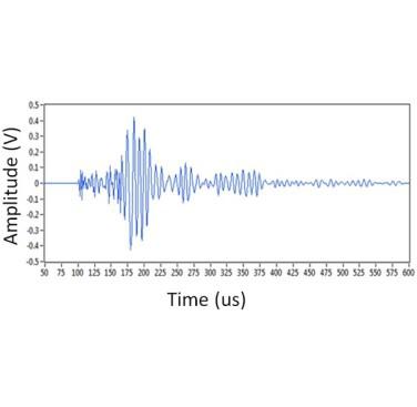

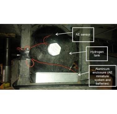

Funded by the European Commission, the two-year ‘SafeHPower’ project saw TWI join a consortium to develop a condition monitoring technique to improve the safety of hydrogen fuel storage tanks. Two prototype monitoring systems were created based upon acoustic emission (AE) technology. Designed to continuously monitor tanks throughout the entirety of the storage, distribution and usage phases in the hydrogen transport economy, the prototypes ensure that all defects that could cause eventual leaks are detected in time to avoid catastrophic failures. One of the prototypes was designed for use with vehicles while the other was developed for use with storage tanks.

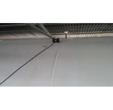

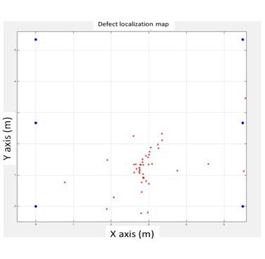

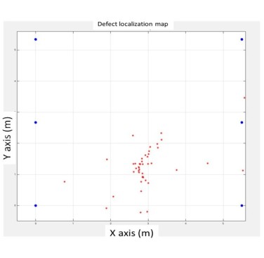

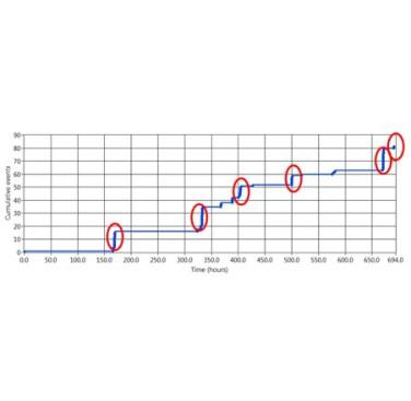

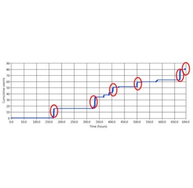

The vehicle prototype comprised an AE sensor, control box and embedded software, with the system designed and developed with several features to enhance its suitability for installation in a vehicle. Laboratory field trials were conducted to test the prototype in conditions representative of real-world operation in terms of temperature and exposure to water, dust particles, humidity and vibrations (Figures 2-4). An AE array system was designed to continuously monitor large storage steel tanks and, crucially, locate the position of any defects with high accuracy. It comprised an array of sensors (three or more), a PXI platform to provide a basis for building electronic test equipment, automation systems and modular instruments, and advanced signal processing software. This system is capable of providing an early warning of fatigue cracks and hydrogen damage before a defect becomes critical. Laboratory validation trials in which water (rather than hydrogen) at a pressure of 220 bar was stored in a tank containing a flaw showed that the developed AE array system is capable of detecting AE events generated by crack growth (50x2x1mm3 and 50x0.5x5mm3). The triangulation method used by the software successfully located the flaw. In addition, field trials were conducted by installing an array of six sensors, for one month, on a large stationary steel tank with a capacity of 50m3. The results obtained from these tests were comparable to the laboratory results obtained on a sample with flaws (Figures 5-6).

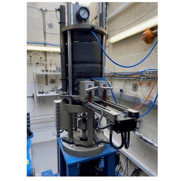

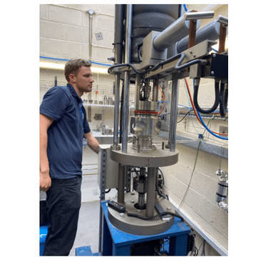

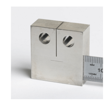

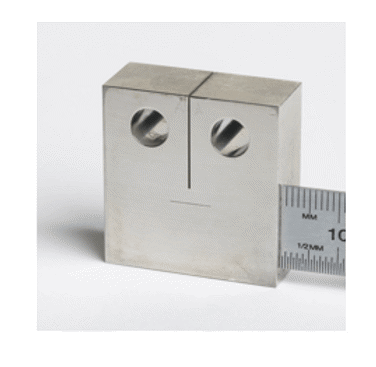

TWI was contacted by Industrial Member, Carten Controls to assist with qualifying materials performance in high pressure pure hydrogen through a series of fracture mechanics tests in accordance with ISO 11114 Part 4. This standard was developed in response to the catastrophic failure of cylinders containing hydrogen gas or hydrogen enriched gases, due to the embrittlement of the containment steels. It also provides a method to approve newer steels, with higher tensile strength but reduced impurities, such as sulphur and phosphorous, to be demonstrated for their suitability for hydrogen storage service, alongside more conventional lower grade steels. Test Method B in the standard is a fracture mechanics test (Method A is a disc test), and the test method involves incrementally loading a 26mm wide pre-cracked compact tension specimen in steps, with a twenty minute hold duration at each step to determine whether any crack propagation can be detected from the direct current potential drop (DCPD) monitoring on the specimen. The tests are done at room temperature within a high pressure gas environment containing the relevant embrittling gas, in this case high purity hydrogen. The largest applied load (in terms of stress intensity factor, K, for the specimen) before crack extension occurs is defined at the threshold value, KIH, for the specimen. If two repeat specimens confirm values of KIH above the target value (equal to 60/950 multiplied by the UTS) then the material is qualified to ISO 11114-4 Method B.
To conduct this work, TWI adapted its existing high-pressure hydrogen testing facility so that the tests could be performed routinely, by developing automated control software to carry out the incremental load increase and hold durations while monitoring the DCPD signal throughout the test. The test method that was developed and then proven through work carried out allowed material to be successfully qualified to the ISO 11114-4 standard on behalf of Carten Controls (Figures 7-9).

Figure 1. Brittle fracture in low-nickel 304L austenitic steel tested in 400 bar hydrogen at –50°C
Figure 2. AE sensor system installed under the vehicle

Figure 3. Typical AE signal detected using the miniature AE sensor system
Figure 4. AE events from a healthy vehicle tank (red circles show the periods of refuelling marked by sharp increase in the AE events)

Figure 5. One of six AE sensors placed on a large H2 storage tank
Figure 6. Bespoke defect localisation map showing the location of the six sensors (blue) along with the estimated defect locations (red)

Figure 7. CT specimen for testing to ISO 11114-4 Method B
Figure 8. Lowering the pressure vessel down over the CT specimen, loaded and instrumented for testing
Figure 9. The incremental load test being carried out inside high pressure hydrogen inside the test vessel
