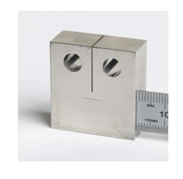

Figure 1. CT specimen for testing to ISO 11114-4 Method B

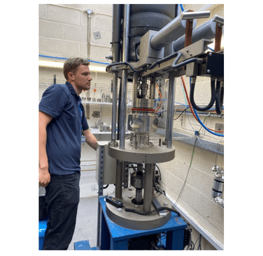

Figure 2. Lowering the pressure vessel down over the CT specimen, loaded and instrumented for testing

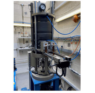

Test Method B in the standard is a fracture mechanics test (Method A is a disc test), and the test method involves incrementally loading a 26mm wide pre-cracked compact tension specimen in steps, with a twenty minute hold duration at each step to determine whether any crack propagation can be detected from the direct current potential drop (DCPD) monitoring on the specimen. The tests are done at room temperature within a high pressure gas environment containing the relevant embrittling gas, in this case high purity hydrogen. The largest applied load (in terms of stress intensity factor, K, for the specimen) before crack extension occurs is defined at the threshold value, KIH, for the specimen. If two repeat specimens confirm values of KIH above the target value (equal to 60/950 multiplied by the UTS) then the material is qualified to ISO 11114-4 Method B.
The Solution
TWI has adapted its existing high-pressure hydrogen testing facility to enable these tests to be performed routinely, by developing automated control software to carry out the incremental load increase and hold durations while monitoring the DCPD signal throughout the test. The test method that was developed and then proven through work carried out allowed material to be successfully qualified to the ISO 11114-4 standard.

Figure 3. The incremental load test being carried out inside high pressure hydrogen inside the test vessel
