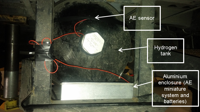

The SafeHPower project developed a miniature AE sensor prototype for continuous monitoring and detection of fatigue cracks in Type IV fuel tanks for vehicles. The prototype comprises an AE sensor, control box and embedded software. The system was designed and developed with several features to enhance its suitability for installation in a vehicle:
  • All power needs are satisfied by the vehicle’s battery.
  • The control box can act as a Faraday cage to provide protection against electromagnetic interference produced by the external electronic components, as well as being resistant to water and dust particles.
  • The embedded software can permanently monitor all AE events and makes a yes/no decision to activate a vehicle dashboard warning.

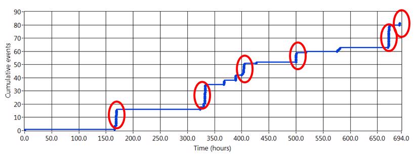

Successful laboratory and field trials have been conducted on composite Type IV and Type III tanks respectively. During the field trials, the AE sensor prototype experienced conditions representative of real-world operation in terms of temperature and exposure to water, dust particles, humidity and vibrations. The results of these field trials showed that the fuelling cycle generates little AE activity (because the tank on the vehicle did not have any defects) compared to the laboratory tests which showed significantly higher activity (because flaws were manually introduced in these tanks).
Figure 1 AE sensor system installed under the vehicle

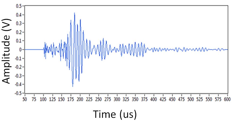

Figure 2 Typical AE signal detected using the miniature AE sensor system
Figure 3 AE events from a healthy vehicle tank (red circles show the periods of refuelling marked by sharp increase in the AE events)

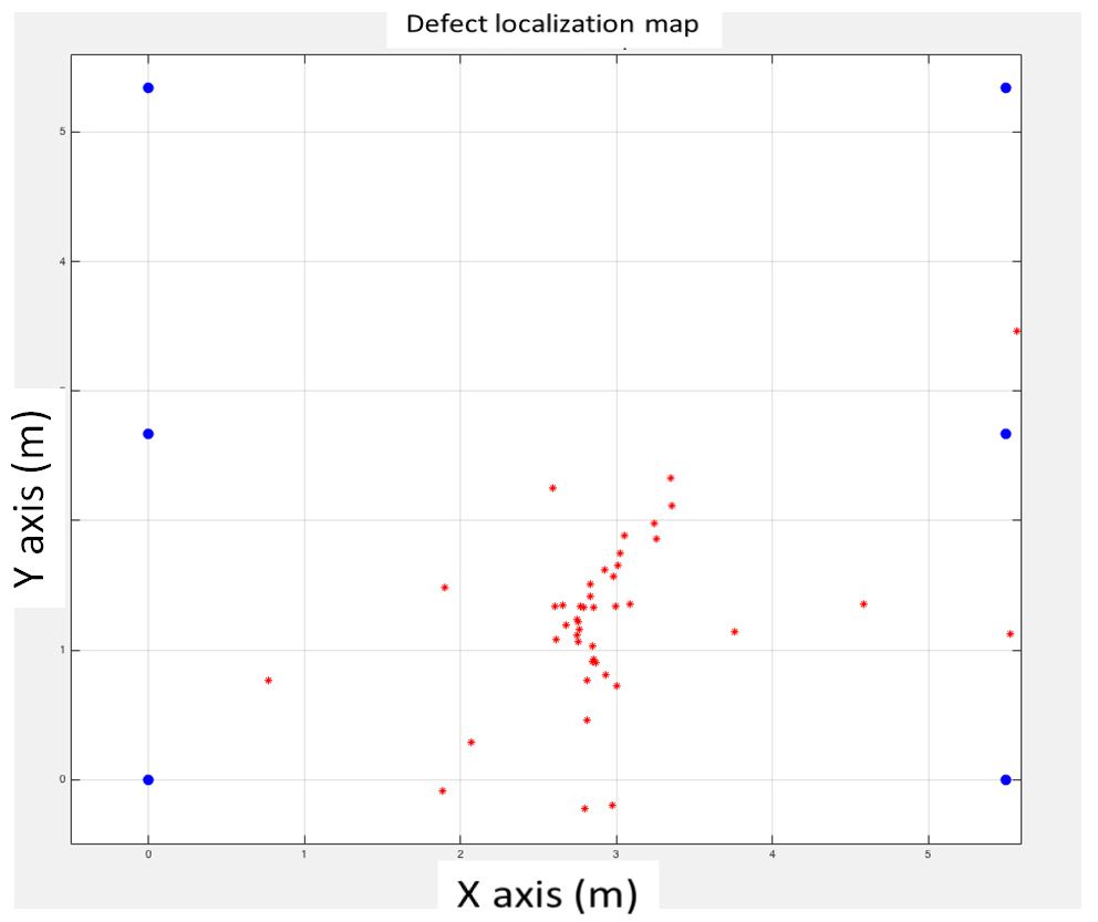

The project also developed an AE array system to continuously monitor large storage steel tanks and, crucially, locate the position of any defects with high accuracy. It comprises an array of sensors (three or more), a PXI platform to provide a basis for building electronic test equipment, automation systems and modular instruments, and advanced signal processing software. This system is capable of providing an early warning of fatigue cracks and hydrogen damage before a defect becomes critical.
The main feature of the system is the bespoke AE signal processing firmware, which had to be designed to cope with a large volume of data due to there being several sensors in the array and a need to monitor longer load cycle periods. Advanced signal processing tools investigate and cover different aspects of the problem. The developed software operates in stages, by performing data loading, normalisation, analysis, thresholding and triangulation. A graphical user interface allows the operator to set up various parameters, view the AE signals from different sensors and locate defects with high accuracy.
Laboratory validation trials in which water (instead of hydrogen) at a pressure of 220 bar was stored in a tank containing a flaw showed that the developed AE array system is capable of detecting AE events generated by crack growth (50x2x1mm3 and 50x0.5x5mm3). The triangulation method used by the software successfully located the flaw.
Field trials were conducted by installing an array of six sensors, for one month, on a large stationary steel tank with a capacity of 50m3. The results obtained from these tests were comparable to the laboratory results obtained on a sample with flaws.

Figure 5 Bespoke defect localisation map showing the location of the six sensors (blue) along with the estimated defect locations (red)
