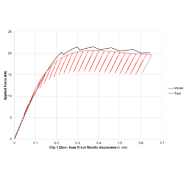

- Evaluating Fracture Behaviour of Pipeline Steel in a Sour Environment at Ambient Temperature
At the time of this 2020 CRP project there was no adequate guidance available in existing standards on sour fracture toughness testing methods for engineering critical analysis (ECA). A fracture mechanics-based approach requires materials properties (tensile properties and fracture toughness) to be precisely defined and the fracture toughness data for the given material be generated under conditions reflecting as closely as possible the service environment. To address this gap, TWI produced a report as the outcome of experimental and analytical work associated with an ambient temperature test programme, including a brief overview of existing guidance on sour fracture toughness testing in current standards and recommended practices as well as results from testing API 5L X65 pipeline steel in a specific sour environment at ambient temperature and pressure. In addition, numerical modelling was used to elaborate the effect of loading (applied during an unloading compliance fracture toughness test) on crack tip hydrogen concentration to understand its link with experimental observations. The report also incorporated the results from assessments carried out for some pre-defined service loading for a hypothetical pipeline system to evaluate the sensitivity of flaw tolerance to the various approaches used to define fracture resistance in a sour environment (Figure 1).

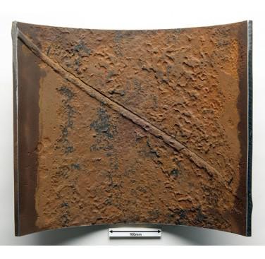

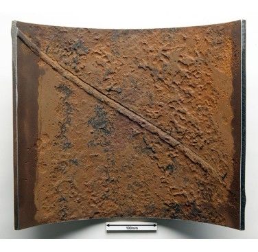

- Failure along Spiral Welds in a Gas Pipeline
The Kuwait Oil Corporation (KOC) called TWI for assistance to find the root cause of a failure in a critical high-pressure wet sour service gas pipeline in West Kuwait. KOC had discovered severe internal corrosion in the pipeline during repairs after it had suffered several leaks, including one due to a crack along a spiral weld. The pipeline was decommissioned and TWI was called to conduct a failure investigation, including extensive examination and testing of the failed pipe.
Our experts noted that the pipe material had been correctly selected for wet sour service and the exterior of the pipe was in a good condition, indicating effective coating and cathodic protection during service. However, visual inspection of pipe samples showed severe internal pitting at the 4-8 o’clock positions at the bottom of the pipe, with a spiral weld failure in the same area (Figures 2-3). Phased array ultrasonic testing then confirmed that the crack was longer on the inside than on the outside, revealing that the cracking originated internally. The presence of water, CO2 and H2S gases were deemed to have caused the internal corrosion, suggesting that the dehydration plant, which was the main source of internal corrosion mitigation in this pipeline, was not functioning adequately. In addition, our experts found that a small weld misalignment had resulted in slight roof-topping of the spiral weld, increasing in-service stresses in these regions and higher local tensile stress when under pressure. Added to this were a small amount of cyclic loading due to regular pipeline shutdowns. Although none of these factors were particularly severe on their own, when combined, the effect could be significant. It was determined that cracking was probably due to increased localised stress at the spiral weld, coupled with corrosion due to the severe sour service environment. As the local stress increased at the spiral weld, the cracking occurred. Following the results of this investigation, KOC replaced the pipeline with a seamless sour service pipe rated to the current level of H2S and water cut.

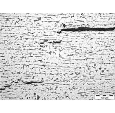

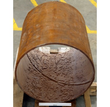

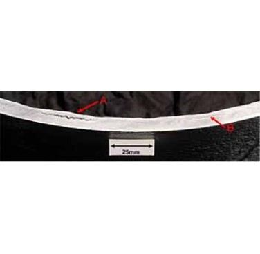

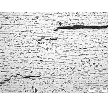

- Fitness-for-Service Project on Middle Eastern Pipeline
The Kuwait Oil Company (KOC) contacted TWI again when internal blistering was discovered in one of their 20" diameter cross-country pipelines. KOC despatched a 200mm long specimen of the longitudinally welded pipe to TWI for analysis along with an undamaged 200mm section from the same pipeline for comparison. The aim was to undertake a fitness-for-service assessment based on the damage and provide advice for future pipeline operation and integrity management.
TWI used several in-house disciplines for this work, including a range of destructive and non-destructive testing methods to confirm material properties, identify damage mechanisms and characterise the extent of the damage (Figures 4-5). We also reviewed the pipeline operating history and available in-line inspection data.
As a result of this investigation, we were able to recommend revalidation methodology for the pipeline based on a hydrostatic proof test as described in ASME B31.8S. The hydrostatic test was successfully completed at 1.7 times the required operating pressure before the pipeline was recommissioned. This delivered significant savings on inspection and repair works to KOC, while demonstrating the safety and integrity of the pipeline.

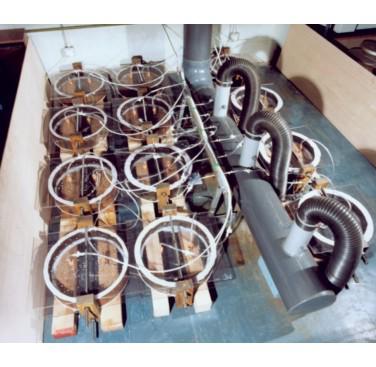

- Hardness Limits Relaxation in the Pipeline
In work supported by the Pipeline Research Committee of the American Gas Association (AGA), TWI was able to confirm that hardness limits for pipe welds could be relaxed without an increased risk of sulphide stress cracking (SSC), paving the way for wider use of high-productivity welding systems.
Although it was known that SSC susceptibility increases with hardness and strength, and that the rapid cooling experienced at welded joints produces hardened microstructures in the heat affected zone (HAZ), the maximum hardness limit stipulated in NACE MR 01 75 was, in principle, too conservative to be applied to all regions of pipeline since low hardnesses were achievable through reheating of root pass regions by subsequent runs. These lower hardness root pass regions could be created on the inside of the pipes, where the corrosive environment tended to be.
To investigate this theory and provide quantitative data to support the view, an experimental programme was conducted at TWI to explore the degree to which the limit could be relaxed for capping pass weld regions, with the potential to greatly reduce the cost of pipeline fabrication. The testing included for both internal and external pipe weld beads to simulate weld root and weld cap regions (Figures 6-7), with the external beads being re-examined with the sour environment on the inside of the pipe. The results showed that an increase in the allowable NACE limit was acceptable, with a similar increase deemed acceptable for BS 4515 at material thicknesses of 9.5mm or more. Not only did this work open up a route to reduced problems and costs with qualifying weld procedures but also facilitated the application of high productivity, mechanised MIG pipe welding systems.

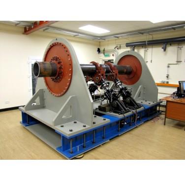

- Full-scale Sour Fatigue Testing Machine for Riser Girth Welds
To provide greater support for our Industrial Members operating in the oil and gas sector, TWI designed and built a unique custom rig capable of testing full-scale pipe welds with an internal sour environment (Figures 8-9). The use of this custom, rotating bending fatigue test machine was created to help eliminate excessive conservatism and provide significant cost savings and improved design flexibility, as well as greater confidence in likely material behaviour in service as a result of quantified material performance. In turn, the improved understanding of fatigue in sour environments led to enhanced safety by reducing the risk of corrosion fatigue-related failure.

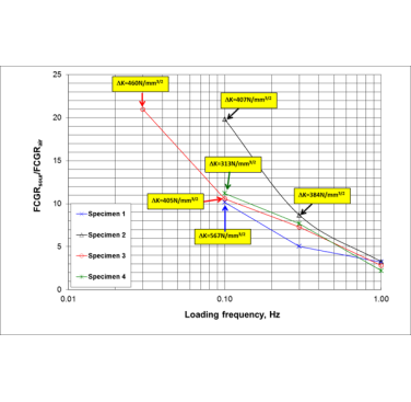

- Frequency Scanning Testing of Armour Wire
TWI Industrial Members, Exxon Mobil asked TWI to develop a testing programme to determine the effect of loading frequency on the fatigue crack growth rate (FCGR) of armour wire in a corrosive environment. To solve the challenge, our expert team developed a frequency scanning test. Single-edge notch bend specimens with a rectangular cross section of 4mm by 11mm were machined from armour wires before FCGR tests in a simulated sour environment were carried out under three-point bending using TWI’s specialist facilities (Figure 13). The environmental conditions were controlled to match those found in-service, allowing TWI to determine the effect of loading frequency on FCGR in the sour environment for the armour wire specimens (Figure 14). The work produced control data that allows for enhanced product design for offshore applications.

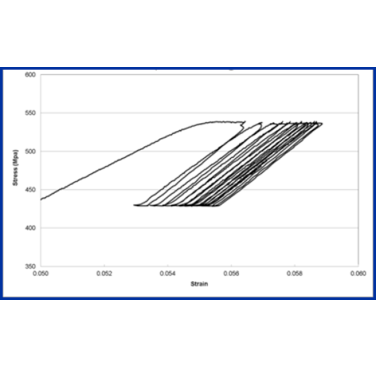

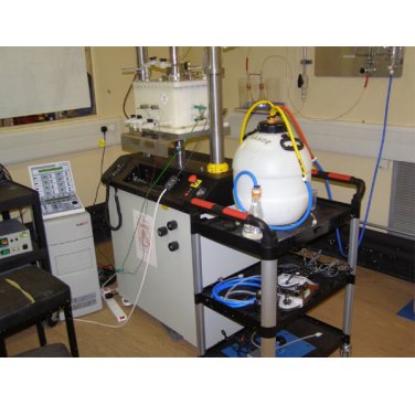

- New Test Assesses Cracking of Corrosion Resistant Alloys
Slow strain rate testing (SSRT) has been used for the assessment of environmentally-assisted cracking of corrosion resistant alloys (CRAs) in the oil and gas industry for environments containing chloride ions and hydrogen sulphide (H2S). However, because this process was not only deemed too severe but also unrealistic in terms of applied stress, a modified SSRT method was developed involving cyclical loading below 0.2% proof stress in order to reduce the severity of the process. This new SSRT test method was further developed to create the ‘ripple load test’ (RLT). The RLT applies slow and repetitive tensile load cycles on a test specimen while exposing it to worst-case operating conditions to accelerate sulphide stress cracking or stress corrosion cracking in susceptible materials. This creates a relatively short test duration that is ideal for assessing the resistance of CRAs to environmentally-assisted cracking. As a result of this work, TWI modified SSRT rigs and developed RLT capabilities (Figures 15-17) that can be used by Industrial Members, including tests to assess stress corrosion cracking resistance on stainless steels in sour environments.

Figure 1. Comparison of finite element model prediction with test data for clip displacement
Figure 2. KOC pipeline sample showing internal corrosion
Figure 3. Detail of internal corrosion in cutaway of KOC pipeline sample

Figure 5. Hydrogen induced cracking viewed under optical microscopy. The image shows a microstructure containing a significant number of laminar inclusions which act as nucleation sites for HIC. Distortion of the microstructure caused by the cracking can be seen, along with step-wise crack growth, which is characteristic of HIC
Figure 6. Testing to reduce hardness limits in pipeline

Figure 8. The custom-built machine at TWI
Figure 9. Configuring the machine

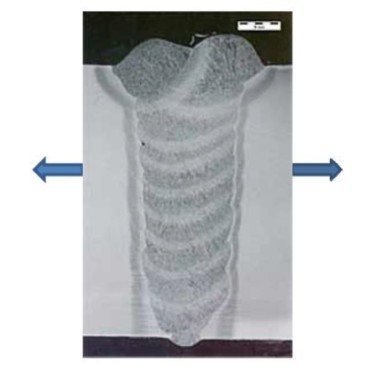

Figure 11. Example of girth weld subjected to a transverse stress, i.e. along the pipe

Figure 14. Normalised FCGR versus loading frequency
Figure 15. Photograph of RLT equipment (ie a modified SSRT rig, with an autoclave used as the environmental chamber)

Figure 17. RLT plots recorded during testing: Stress vs strain
