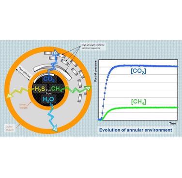

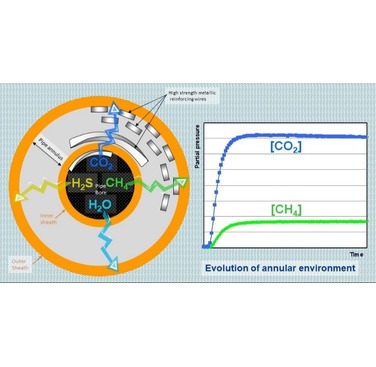

Although not usually severe, CO2 corrosion of annular elements has previously been reported (Taylor et al., 2002; Wood, 2017). Furthermore, unusual instances of cracking in CO2 rich environments in the Brazilian pre- pre-salt have been reported (De Motte et al., 2022). The environmental conditions of the annulus are not straightforward to predict or measure due to the confinement of the wires and the supply of corrosive components via permeation from the bore (see Figure 1). Temperature, partial pressure of acid gases and the degree of occlusion all influence the corrosion rate.

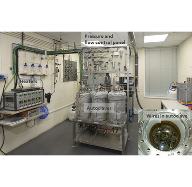

A specialised test facility was commissioned with appropriate instrumentation (see Figure 2).  Three autoclaves were operated in parallel at different temperatures, to allow data for three different temperatures to be collected simultaneously.  The occlusion ratio (V/A) of the aqueous environment, gas flow rate and partial pressures were defined and continuously monitored.
Figure 1. Evolution of annular environment through permeation
Figure 2. Laboratory for simulated annulus testing

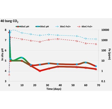

The long term nature of environmental evolution under nominally constant conditions was reflected in the results (see Figure 3). The pH was seen to stabilise after approximately 30 days, whereas the iron concentrations that developed to peak values within the first few days continued to reduce beyond the 30 day mark.  Indeed, the effect of temperature and pressure was more pronounced in the absolute Fe concentrations than for the pH values, although trends between them were similar.  Water chemistry models agreed well with the pH measurements when the actual Fe2+ concentrations were inputted.

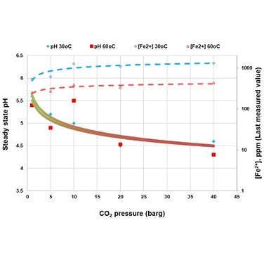

Over the range investigated, increasing the CO2 partial pressure increased [Fe2+] and reduced the pH (see Figure 4).  The effect of temperature on pH was not consistent at all pressures but overall, an increase in temperature related to a reduced pH.  The effect of temperature was more evident in the [Fe2+], with higher concentrations at lower temperatures.

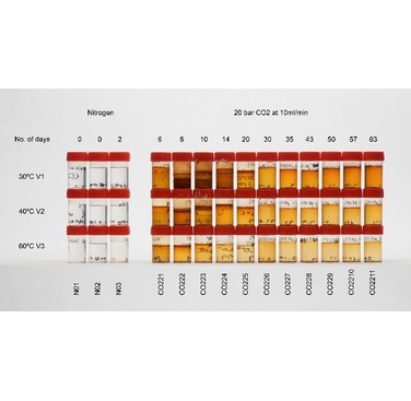

For a given test temperature and CO2 partial pressure, the pH increased with the concentration of dissolved iron concentration.  The test solution remained supersaturated with iron throughout the duration of the experiments.  The variation of [Fe2+] could be visualised in the aliquots removed (see Figure 5).
The dissolved iron concentration is associated with the CO2 corrosion mechanism of steel (Nešić, 2007, Nyborg, 2002). Dissolution of CO2 acidifies the solution and accelerates the anodic dissolution of steel. The solubility of CO2 increases with pressure, explaining the more rapid acidification of solution and dissolution of Fe at 40barg CO2 partial pressure. However, the pH values appeared to substantially converge towards the end of the tests, whereas differences in dissolved iron concentration vs. temperature persisted. The stabilisation in pH values for all test temperatures at 40barg CO2 and 20barg CO2 over the long term can be attributed to the stability, structure and thickness of the scales formed.

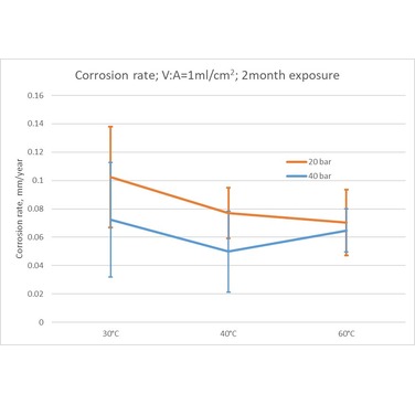

It was shown that the corrosion rate decreased as CO2 pressure and temperature increased (see Figure 6).  This is in keeping with trends reported for carbon steels at partial pressures between 15-80barg CO2, 50-65°C (Choi, 2011; Bai, 2018).  However, in contrast to these studies, where corrosion rates were reported to vary between 1 and 20mm/year, the annular corrosion rates in the present study were found to be an order of magnitude lower, at circa 0.1mm/year.  The low corrosion rates are associated with the V/A, i.e., the degree of occlusion of the annulus and the supersaturated conditions.

Figure 3. Solution pH and Fe concentration over time
Figure 4. Effect of CO2 pressure on pH and [Fe2+]
Figure 5. Visual indication of [Fe2+] seen in aliquots extracted over the test duration
Figure 6. Corrosion rates calculated from mass loss
