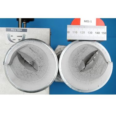

As expected, the bolts tended to fail on the loaded flank of the first engaged thread (see Figure 1.).  Galvanised bolts whose threads had been manufactured by rolling had a lower fatigue performance than uncoated bolts with the same thread manufacturing route.  The fatigue performance of galvanised bolts in artificial seawater spray was below their performance in air, but the galvanised coating offered some protection against the corrosive effect of seawater spray, because the fatigue life was only a factor of 1.8 lower than in the in-air performance.

Figure 1. Fracture faces of a cracked M72 bolt
