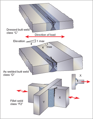

The basis of all the rules is a system whereby various joint designs are assigned a 'classification' related to the joint's fatigue performance. Fig.1 is an example of how this classification has been formalised in BS 7608 - the same or similar methods will be found in other application standards.
Fig.1. Examples of joint classification from BS 7608
In BS 7608 each joint type is assigned a classification letter. For example, a plate butt weld with cap and root ground flush is class 'C', an undressed plate butt weld class 'D' and a fillet weld class 'F' ( Fig.2).
