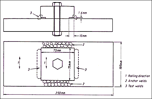

To assess the risk of solidification cracking, a 'circular patch' test can indicate susceptibility (see Fig.1). A circular test patch is removed from the centre of the test material and is bolted to a large restraining plate. The test material is positioned such that the gap around the test patch is constant, and is fillet welded in position on the restraining plate. A weld between the patch and the original plate is made, following the circumference of the patch. Centre-line and other solidification cracking can be observed, and the sample tested to determine whether any buried cracking exists.
In order to assess the risk of hydrogen cracking, a number of tests (and non-test methods) are available. EN 1011-2:2001 Annex C describes two methods for determining the welding parameters to avoid hydrogen cracking. This is available online in the Preheat toolkit. If testing is required, a number of options are available: A Tekken or Y-groove test is a highly restrained butt-weld test for HAZ (heat-affected zone) hydrogen cracking; the CTS (controlled thermal severity) test is a highly restrained fillet weld test. Test selection will depend on the material and joint configuration of interest, and details of these tests are in JIS Z 3158:1993(R2013) and BS 7363:1990 AMD2004. A number of conditions are selected in order to determine the cracking threshold, e.g. one preheat level, multiple heat inputs or multiple preheat levels with one heat input.

The tests outlined above are shown in Fig.1.
Fig.1. Tests for evaluating weldability The circular patch test
The Houldcroft Fishbone test
The y-groove test
The y-groove test
The Controlled Thermal Severity (CTS) test
