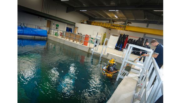

                             Water resistance testing at TWI North East’s 7m dive tank facility

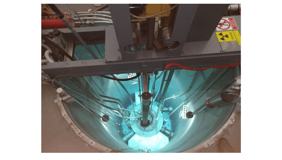

                             Testing the sensors in at the Joseph Stefan Institute (JSI), Ljubljana, Slovenia nuclear reactor
