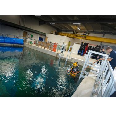

Figure 1. Water tightness testing in TWI’s 7m dive tank

UT sensors can be manufactured from different piezo-electric materials. As part of the scope, project partner Precision Acoustics Limited (PAL) developed piezo-polymer and fibre optic UT sensors and Ionix Advanced Technologies Ltd (Ionix) created piezo-ceramic based UT sensors. TWI developed a method for attaching UT sensors to stainless steel mineral insulated copper core (MICC) cables. These then underwent thorough testing including water tightness testing, which took place at TWI’s dive tank facility at TWI’s North East Technology and Training Centre in Middlesbrough, as well as impendence testing and signal testing (Fig.1). Project partner, University of Sheffield (UoS), modelled the radiation exposure of the components so that selective radiation hardening could be applied to the electronics where necessary. The model was sufficiently close to the actual exposure that it could be used to simulate the gamma exposure for different components to allow them to be modified to maximise their life before physical testing.

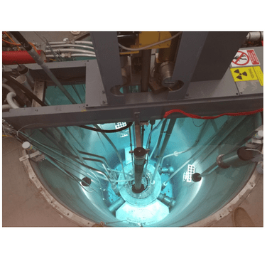

TWI researched European nuclear facilities that would be suitable to test the radiation resilient cables. Two facilities – The University of Manchester’s Dalton Nuclear Institute and The Joseph Stefan Institute (JSI), Ljubljana, Slovenia – were identified as appropriate for testing. The Dalton Nuclear Institute was used to expose the cables to gamma radiation, whilst the Ljubljana facility was used to expose the cables to neutron + gamma radiation (Fig.2). Both types of UT sensors were inserted into the reactors and their operation monitored during exposure to the different radiation types. The gamma exposed sensors (Dalton) were suitable for offsite testing whilst the neutron + gamma sensors (JSI) where too highly radioactive to be removed from site. Samples of piezo-polymer material where exposed to radiation in both facilities and these were suitable for offsite testing once their residual radiation level had decreased to an acceptable level. Testing at Dalton demonstrated that the polymers used in conventional cabling are susceptible to gamma radiation damage and should not be used under radiation conditions.

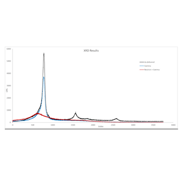

Samples of the piezo-polymer from PAL were investigated using XRD to characterise their level of crystallinity. The gamma irradiated sample had structural damage and its crystallinity and associated piezoelectric response had been reduced to below a useable level, while the neutron and gamma irradiated sample displayed a single much lower and wider peak, indicating significant structural damage by the neutron bombardment (Fig.3).

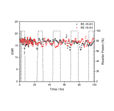

The UT sensors from Ionix, utilising a MIMS cable, showed resilience to both gamma and neutron radiation in experiments at both facilities, offering a solution for ultrasonic condition monitoring in a nuclear facility or reactor. There was no observable degradation in performance at doses of 11 MGy gamma, and integrated neutron flux of 2.6 x1018 n.cm-2.

XRD investigations revealed that gamma radiation reduced the crystallinity of polymer samples, nullifying the piezoelectric effect, whilst neutron + gamma radiation significantly altered the structure of the polymer, totally diminishing the piezoelectric effect.

Figure 2. Radiation exposure testing at Joseph Stefan Institute (JSI), Ljubljana, Slovenia

Figure 3. XRD results of irradiated samples

Figure 4. Signal to noise ratio (SNR) (circles) for two transducers irradiated in the TRIGA reactor and the reactor power (dash) over 100 hrs. Total dose recorded was 11 MGy gamma, and integrated neutron flux 2.6 x1018 n.cm-2
