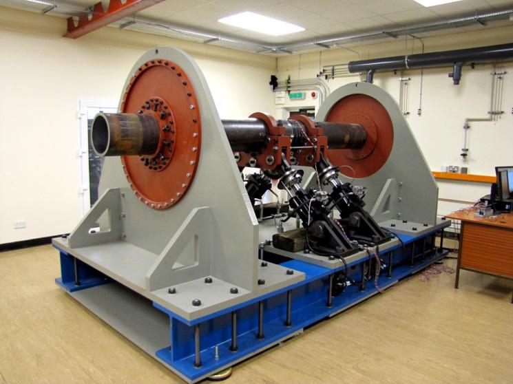

Fig 1. The custom-built machine at TWI
Test machine
Phase one of the project involved the design and manufacture of a rotating bending fatigue test machine capable of testing full-scale pipe welds with an internal sour environment. This can be seen in Figure 1.
The machine incorporates several novel features:
  • Orthogonal pairs of hydraulic actuators permit in-plane bending, rotating bending, or anything between the two, up to +/-250kNm bending moment.
  • Large diaphragms support the pipe at its ends, permitting angular rotation while maintaining axial alignment.
  • A unique internal jack/column system allows up to 2MN of axial preload to be applied to the pipe.
  • An internal annular sour cell permits circulation of a controlled environment around the weld root region without compromising the internal column system.

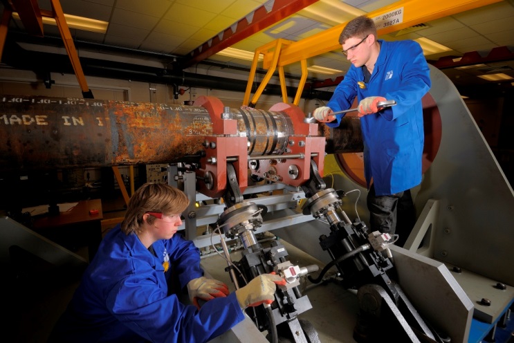

Fig 2. Configuring the machine
