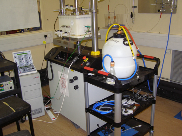

Figure 1 TWI facilities used for the FCGR testing of armour wire.

Single-edge notch bend specimens with a rectangular cross section of 4 by 11mm were machined from armour wires with a cross section of 4 by 12mm.  FCGR tests in a simulated sour environment were carried out under three-point bending using specialist facilities available in TWI (Fig.1) where environmental conditions can be carefully controlled to represent those in service.

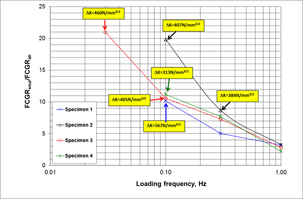

To determine the effect of loading frequency on FCGR, the team carried out frequency scanning FCGR tests where the load range was gradually and automatically decreased after each small increase in crack length to keep stress intensity factor range, DK, constant in each test. The loading frequency was decreased in regular steps after a certain crack extension.
Effect of loading frequency on crack growth rate
TWI successfully determined the effect of loading frequency on FCGR in the sour environment for the armour wire specimens. The figure below shows the FCGR in the sour environment normalised with the FCGR given in BS 7910 for steels in air. It can be seen that the FCGR of armour wire in the sour environment increased sharply with decreasing loading frequency, with a normalised FCGR value being increased from ~3 at 1Hz to ~11 at 0.1Hz, and to ~21 at 0.03Hz [1].

Figure 2 Normalised FCGR versus loading frequency.
