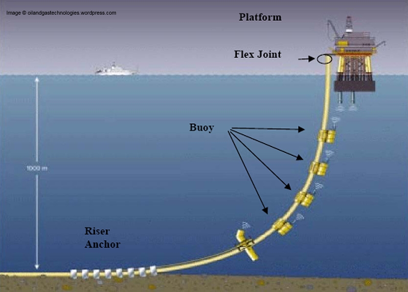

Figure 1 Example of a steel catenary riser
Designed to withstand the deep
As illustrated in Figure 1, a deepwater riser is a type of vertically oriented pipeline connecting subsea hydrocarbon facilities to a drilling/production unit. In one direction, they transport produced hydrocarbons from the well, whilst in the other they may carry control/injection fluids from the platform to the seabed. In view of their contents (highly flammable fluid under high pressure) and their proximity to the platform (which may be manned) and to supply shipping, ensuring the structural integrity of risers is of paramount importance.

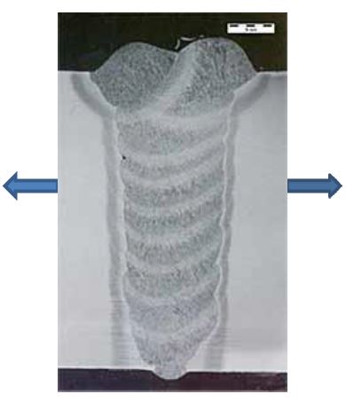

Risers are made by welding multiple lengths (approximately 12m long) of linepipe together, either in the field or long before installation (in the latter case, they are reeled onto a spool and reeled off at the point of use). Whichever installation method is used, the structural integrity of the girth (circumferential) weld is of particular significance, since girth welds are subjected to cyclic (fatigue) loading and are typically uninspectable once installed. Leakage or failure of a riser could, of course have disastrous consequences for human safety, for the environment, and for the
cost-effectiveness of the field.
Although the weld (an example of which is shown in Figure 2) is made by an automated process and to a very high quality, it should be recognised that any welding process has the potential to introduce flaws, and the ability of non-destructive testing (NDT) to detect, size and, if necessary, reject such flaws needs to be critically considered. In practice, failure of the girth welds is avoided by careful attention to the quality of materials, welding and inspection, backed up by an ECA, which is a quantitative analysis of the relationship between flaw size, materials properties and the loading on the riser. In this way, it is possible to ensure that flaws that might escape detection during NDT will not grow large enough to lead to failure of the riser during its design life, as illustrated in Figure 3.

Figure 2 Example of girth weld subjected to a transverse stress, ie along the pipe
