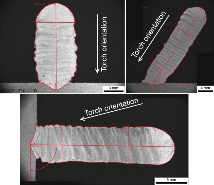

The CMT process was able to construct “walls” and “pads” by performing multipass welds with either a vertical or horizontal offset. While the production of vertical walls and pads was easily achieved with a standard vertical torch alignment, the experimental trials showed that structures could be produced with a range of orientations by varying the torch angle in line with the desired orientation. Figure 1 shows an example of the range of orientations achieved, by building up on a horizontal substrate. All of these different orientations were produced with similar deposition rates.
It is reasonable to extrapolate from these initial trials that it is possible to produce multi-angled structures for use in either repair of pre-existing components, or to generate complex geometries without significant machining.
Figure 1 – Range of produced orientations achievable by the CMT process

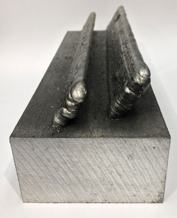

The technique was demonstrated to be capable of producing good quality deposits free of porosity, showing good inter-layer fusion, and with an impressive regularity when performed even at an angle as shown in Figure 2.
A range of weld bead sizes was produced, allowing variation in the bead height and width between 1-3mm and 1-5mm respectively. This allows the process to be tuned based on the desired final component shape, with the ability to minimise the number of passes needed for a given geometry.

Figure 2 – Example of weld beads produced with a 60 degree angle
