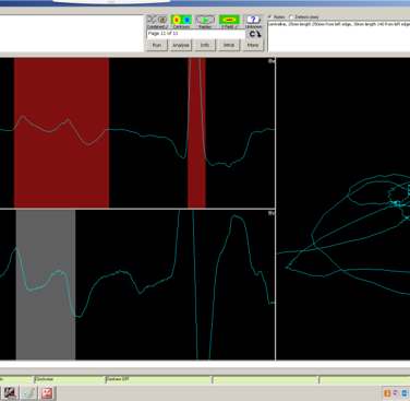

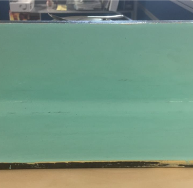

The feasibility study was carried out on a manufactured fillet weld that had known embedded defects. This was used as a benchmark for future ACFM inspections and was conducted in accordance with the ASTM Designation E2261-07: Standard Practice for the Examination of Welds Using the ACFM Technique Standard. Due to the size of the weld cap, three scans were carried out; one scan on each toe and one scan on the weld centreline. The three scan lines were sufficient to cover both the entire cap and part of the adjacent weld parent material. The technician inspected both a painted fillet weld (figure 1) and an unpainted fillet weld (figure 2). This was backed up by tests on a second unpainted sample where the defects were easily located. This sample was then coated and retested by our experts who determined that, although the signature was less defined, it was still sufficient to detect and measure the defects accurately (figure 3). The coating caused a decrease in amplitude that delivered different calculated depths between the coated and uncoated samples, making it essential to confirm the thickness and nature of the paint and to include this in the scanning or analysis stage. However, the feasibility study showed that ACFM was effective for detecting defects in the coated materials.

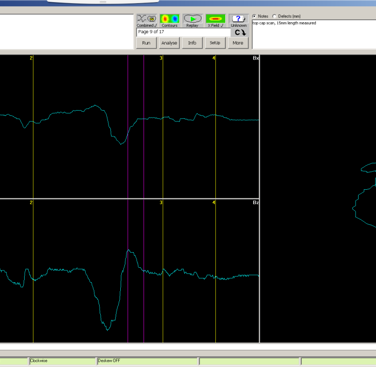

With the first phase completed successfully, the next phase was to inspect the client’s tank floors on-site to detect any surface-breaking defects without removing the coating. Our inspectors travelled to the site and used ACFM to inspect the tank floors. A defect was located (figure 4) which was confirmed with the use of magnetic particle inspection. A post-inspection data analysis step followed before a report was produced detailing defect sizing and defect depth.

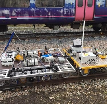

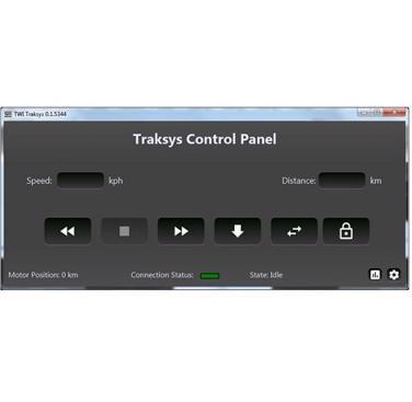

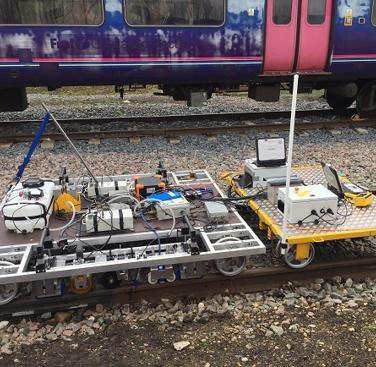

This project built on previous developmental work undertaken by TWI, with the solution being to mount the inspection system on an autonomous cart. Our experts used their experience in systems integration to deliver industry standard hardware, embedded systems and radio controllers to manage the control and flow of messages and data between the track side application (Figure 5) and the cart (Figure 6).
TrakSys delivered an agile, mobile inspection system that provides continual track inspection coverage supporting a regime of targeted repair while reducing annual maintenance costs. This successful completion of this project opened a number exploitation routes in autonomous rail inspection for the project partners.

Figure 4: ACFM signal from the area with the defect
Figure 5: The application used to control the TrakSys inspection cart
Figure 6: The complete TrakSys inspection cart
