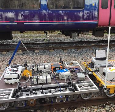

Innovate UK’s Accelerating Innovation in Rail funding builds on developmental work undertaken by TWI, TSC and CATER-EU, to combine ACFM, ultrasonic and visual inspection systems. The inspection system is mounted on an autonomous cart, combining inspection and position data to form scanned area maps. This approach enables a richer and more accurate depiction of track condition to be provided to the decision maker.

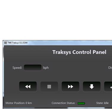

TWI’s role as system integrator delivered industry standard hardware, embedded systems and radio controllers to manage the control and flow of messages and data between the track side application (Figure 1) and the cart (Figure 2). This successful project conclusion has opened a number exploitation routes in autonomous rail inspection for the SME partners.

Figure 1: The application used to control the TrakSys inspection cart
Figure 2: The complete TrakSys inspection cart
