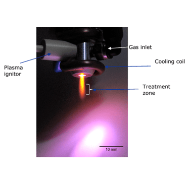

In 2020, we investigated the use of gas plasma treatment for structural adhesive bonding of metals. This core research work was undertaken to find a more universal alternative to wet chemical etching. Wet chemical etching requires different chemical etchants for different metals. Each etchant also has its own set of immersion processes to clean and treat each material; which, in turn, affects the energy consumption, consumables and time required. Cold atmospheric plasma (CAP) was tested an as an industrial alternative, with stainless steel (316) and titanium alloy (Ti 6Al 4V) being chosen as test materials due to their frequent use in industrial settings.
The project outcomes showed a number of benefits with the CAP process (Figure 1), including improved performance, a simplification of the pre-treatment process, less energy intensive and thereby more environmentally-friendly, and a high potential to be adaptable to different materials and applications.

Figure 1: Cold Atmospheric Plasma Plume
