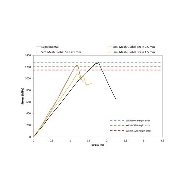

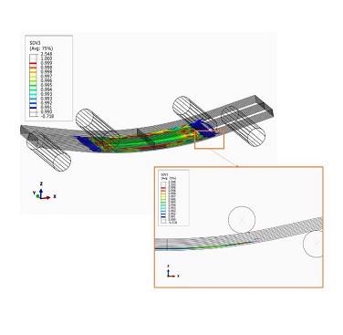

During the first phase of the study, damage initiation and evolution were studied using continuum damage mechanics (CDM). Hashin’s and Puck’s criteria were selected as suitable damage criteria, as they provide information about failure modes and the location of damage. These criteria were implemented in models and their performance was assessed against experimental results generated from static four point bending tests in a TWI-led Clean Sky European project, HEGEL (Grant agreement ID: 738130). A sensitivity study was undertaken with respect to the modelling approach for the lay-up sequence, mesh element type and mesh element size. It was observed that stress levels causing failure in the laminate could be predicted with an acceptable margin of error (within 5%) – Figure 1. The models were also successful in representing the main mechanism of failure observed experimentally, i.e. failure of the matrix in tension in the outermost ply (Figure 2).
Figure 1. Comparison of constant strain rate (CSR) simulated data with experimental CSR data
Figure 2. Representation of damage initiation using a CDM-based model: The damage occurs by matrix failure in tension at the outermost 90° ply

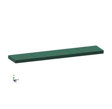

Figure 3. Inclusion of inherent defects (in red) in a four-point bending specimen model. The specimen under consideration is a 80mm x 13mm laminate, with [0/90/0/90/0]s stacking sequence. A python script was developed capable to introduce defects within the laminate, based on experimental statistical data from computed tomography scan of the defects
Whilst a CDM approach uses damage variables to represent a typical crack density in a composite, damage initiation conditions will predominantly be controlled by material strength, and lay-up sequence. As a result, it was noted that, if the minimum stress levels required to achieve such conditions were not reached, damage initiation would not occur and, as a result, damage accumulation could not take place. In real materials, damage initiation usually nucleates from pre-existing flaws (e.g. manufacturing defects) within the laminate and, as a result, the stress level required to initiate damage can be much lower compared with that required in ideal laminates. This indicates that capturing the realistic distribution and morphology of pre-existing flaws is crucial for acceptable prediction of damage in composite parts. This challenge was addressed by identifying and implementing a phenomenological approach to damage modelling. This required the development of a modelling strategy able to include “inherent” manufacturing defects on the basis of relevant statistical data from experimental observations, i.e. void volume fraction, morphology, dimensions, location and orientation (Figure 3). Fracture mechanics based models, using the Virtual Crack Closure Technique (VCCT) or extended FEM (XFEM), were subsequently implemented. The validity of the approach was demonstrated against experimental data from flexural four-point bending fatigue testing generated during the HEGEL project (Figure 4). The use of the proposed phenomenological approach enabled a parametric study of damage behaviour in composites with respect to size and percentage of defects within the part.

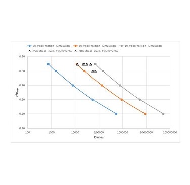

Figure 4. Example of fatigue master curves generated as a function of void volume fraction and applied stress. The experimental data points for composite laminates with a void fraction ranging between 1% and 2% are observed to be in between the simulated master curves obtained from FEA models containing 1% and 3% void fraction
