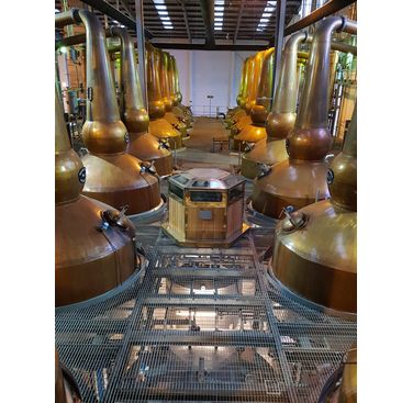

Copper stills at Grant's Distillery were used for data collection
