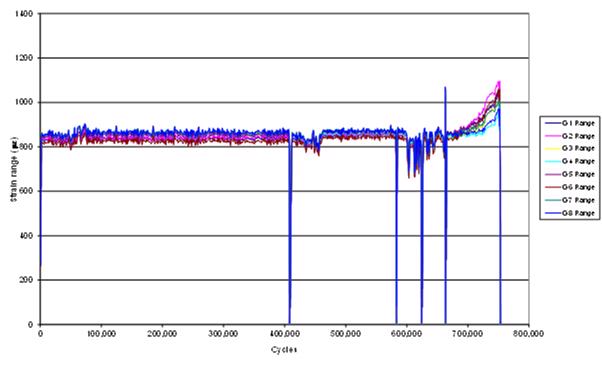

Cracking was first detected with water leakage, of green colour, from one drilled hole.  The hole was then plugged and the test re-started.  After a few cycles, the specimen tripped from the second drilled hole with water leakage of green colour.  The second hole was also plugged and the test re-started until through wall cracking occurred.  Cracking was indicated by the strain gauge readings (Figure 1).

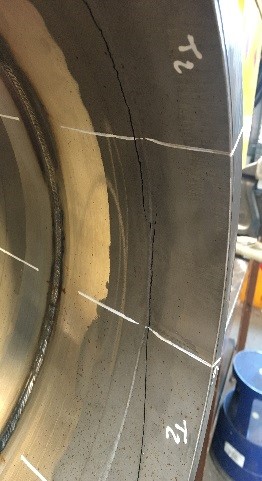

The MLP was then cut and dye penetrant inspection was carried out on the clad overlay / liner transitions.  Cracks were detected in the liner on each side of the girth weld (Figure 2).
