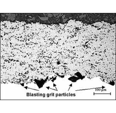

Microstructural Characterisation of HVOF Sprayed Tungsten Carbide-Cobalt Coatings
At the time of this project, in 1997, high velocity oxyfuel (HVOF) spraying was increasingly being considered as a viable alternative thermal spraying process to air plasma and detonation flame spraying for the preparation of high-quality coatings of tungsten carbide-cobalt (WC-Co). These coatings were being used by industry to provide protection against wear such as abrasion, adhesion, fretting and particle erosion. Despite the effectiveness of this protection being dependent on the microstructure of the deposited coating, there was very little published information on the microstructure of HVOF sprayed WC-Co coatings and how this influences wear performance. This project addressed this gap by characterising the microstructure of two HVOF sprayed WC-Co coatings using scanning electron microscopy, X-ray diffraction and chemical etching techniques in order to determine the microstructure necessary to give best resistance to abrasive wear.

- Surface Characterisation and Preparation for Thermal Spray Coatings - Technical Review
The bond strength between a substrate and a coating is dependent on surface preparation of the substrate and using optimised spray parameters. Although the parameters are usually carefully monitored and controlled, most surface preparation is performed via manual grit blasting with little to no process monitoring or calibration. In 2015, our experts undertook a review of surface preparation techniques for the application of thermal spray coatings in order to improve surface preparation using mechanised processes to ensure a tighter control of grit blasting and repeatability. We also investigated different methods of surface characterisation and other surface preparation techniques.

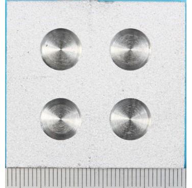

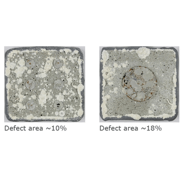

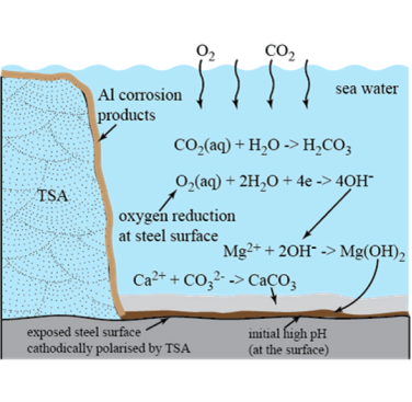

- Damage Tolerance of Thermal Spray Aluminium (TSA) Coatings
Carbon steel is the material of choice for offshore wind structures although it is prone to corrosion in marine environments, which means that corrosion mitigation systems such as coatings or cathodic protection need to be used. Thermally sprayed aluminium (TSA) is often used as a barrier system in all marine environments, offering cathodic protection to immersed steel structures. However, despite the frequent use at the time of this project in 2021, it was not clear how these coatings perform over long periods in the presence of damage. Previous studies had focused on single, small-scale damage exposing up to 5% of the area. However, the effect of multiple or large-scale damage exposing around 20% of the area had not been studied in detail. In addition to the dissolution of the aluminium coating, the deposits (if any) formed on the damaged regions also play a role in the corrosion kinetics. The evaluation of the deposits on the defect regions was carried out to understand their role in the corrosion process and thus ascertain if the deposits offer any protection (Figures 1-3). Twin wire arc spray was used to coat S355 steel with Al (1050) before the coated steel specimens were exposed to synthetic seawater in a bath kept at 25°C with no applied potential. The open circuit potentials were monitored against a standard Ag/AgCl reference electrode and the coated steel specimens had various levels of holidays (~5, 10, 15 and 18%) drilled on the front surface while the back surface was coated in lacquer. Microstructural characterisation and phase determination was carried out after testing and the data was analysed and used to develop an understanding of the corrosion mechanisms.

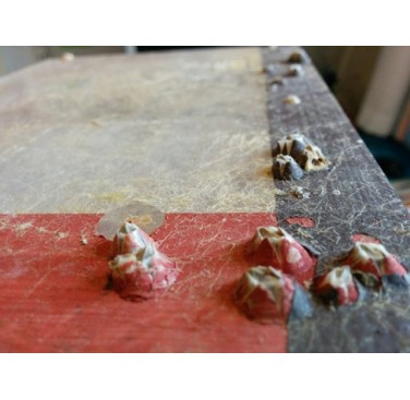

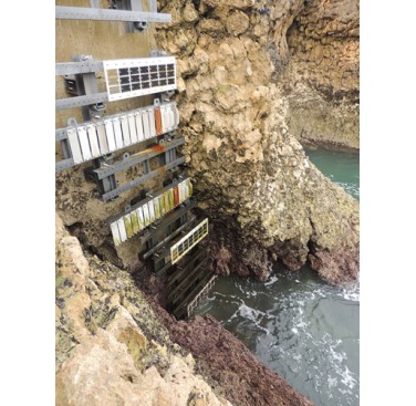

- New Coating Resists Corrosion and Biofouling
TWI’s expertise in thermal spray coatings for offshore applications was called upon as one of seven organisations working on the collaborative, EU-funded ACORN project. Thermally sprayed aluminium (TSA) was combined with eco-friendly, low-release-rate biocides, capable of preventing barnacles from settling on surfaces. Barnacle settlement causes huge amounts of damage, cutting through paints, blocking key access points and making structural inspection problematic as well as promoting further settlement of other marine species, further compounding the problem of bio-accumulation (Figure 4). Developed at TWI, the new coating technology was extensively tested in simulated offshore conditions and through two sets of field trials (Figure 5).

Figure 1a: Photographs of specimens before testing showing holiday (defect) size and distribution. Specimens were approximately 40mm×40mm. The percentage of defect area is approximately 5%
Figure 1b: Photographs of specimens before testing showing holiday (defect) size and distribution. Specimens were approximately 40mm×40mm. The percentage of defect area is approximately ~18%
Figure 1c: Photographs of specimens before testing showing holiday (defect) size and distribution. Specimens were approximately 40mm×40mm. The percentage of defect area is approximately ~18%
Figure 2. Photographs of specimens after 420 days of testing in ASTM D1141 synthetic seawater
Figure 3. Schematic showing the mechanism of deposit formation in TSA-coated steel containing defect
Figure 4. Barnacles settle on surfaces and breach through protective paint layers, causing extensive damage to the surface
Figure 5. ACORN project field trials
Figure 6. SEM image of tungsten carbide cobalt coating
