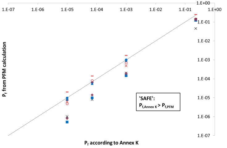

This project demonstrated the ability of the new software to reproduce selected models used in the derivation of the PSFs in Annex K of BS 7910:2013 (see Figure 1). However, it also revealed that the agreement between Annex K and a direct PFM approach is weak, except for certain specific cases against which the model was originally calibrated. A direct PFM approach is therefore preferable to the use of PSFs to achieve a particular target Pf.

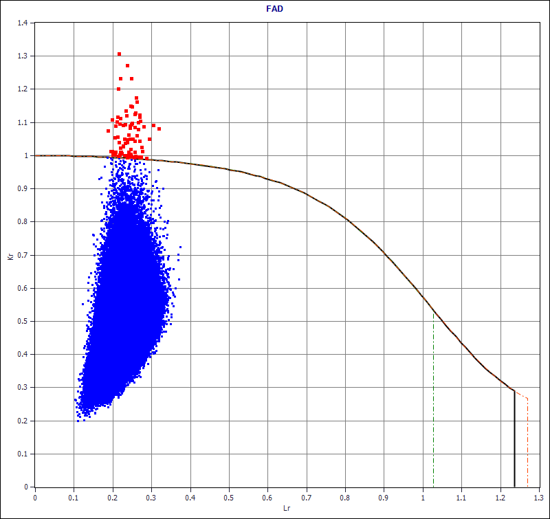

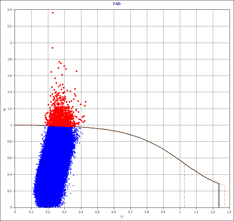

There are a number of outstanding challenges in the application of PFM (including the availability of high-quality data and the skill required of the analyst) to real engineering structures. Nevertheless, this work showed the ability of the software to calculate the relative effects of important variables, such as the scatter in tensile properties and fracture toughness, or the precision of the non-destructive testing technique (see Figures 2 and 3, overleaf).

Figure 1. Comparison of PSF calculations using CrackWISE with those implied in Annex K of BS 7910 (different symbols denote different models).
Figure 2. Example of the output from the probabilistic version of CrackWISE; Pf (8x10-5 in this case) is the ratio of point outside the FAD (red) to the total number of assessment points.
Figure 3. Example of the effects of NDT precision on reliability; by increasing the scatter in flaw size (with no other changes to inputs), Pf has risen by a factor of 16 relative to the previous diagram.
