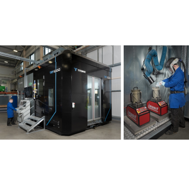

A functionally graded material (FGM) architecture (W → B4C → Eurofer97) was developed using CSAM, supported by neutronics analysis. Powder blends were engineered with suitable binders to enable deposition of metal matrix composites (MMCs) incorporating shielding materials. Process optimisation focused on balancing deposition efficiency, shielding material retention, and interfacial integrity. Demonstrators were produced in planar and tubular geometries and characterised using detailed microscopy, hardness, and dilatometry. Figure 1 shows the Titomic TKF-1000 CSAM cell at TWI that was used for this study.

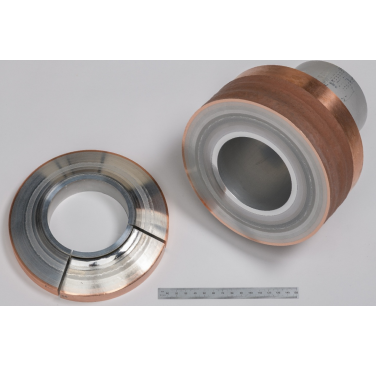

Small-scale planar (120×75×20mm) and tubular (Ø178×300mm, ~38mm wall) demonstrators validated reproducible processing and integration of ceramics, refractory metals, and steels into a single monolithic graded-Z architecture.

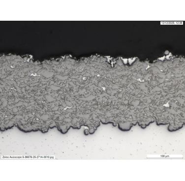

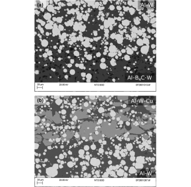

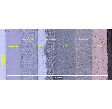

Figure 2 presents a representative micrograph of the as-deposited CSAM small-scale graded-Z shielding demonstrator, illustrating the layer sequence from the substrate to the outer surface. Figure 3 shows representative SEM images of the FGM interfaces, while Figure 4 presents a cross-sectional micrograph of a cold sprayed MMC exhibiting >98% W retention. Figure 5 shows the CSAM small-scale graded-Z shielding demonstrator following post-processing.

Figure 1. TWI’s Titomic TKF-1000 Cold Spray Additive Manufacturing (CSAM) cell, featuring a dual powder feeder suitable for co-deposition of powders, enabling functional grading or multi-material deposition
Figure 2. Representative stitched images of the cross-section of the as-deposited CSAM small-scale graded-Z shielding demonstrator, showing the layer sequence from substrate to outer surface
Figure 3. Example SEM images showing FGM interfaces: (a) Al-B4C-W to Al-W, (b) Al-W to Al-W-Cu
Figure 4. Example cross-sectional optical micrograph of a cold sprayed MMC with >98% W retention, deposited onto an Al substrate

Figure 5. CSAM small-scale graded-Z shielding demonstrator (cylindrical geometry) after post-processing: 89mm internal diameter, 178.6 mm outer diameter, and 38.5 mm wall thickness. Layer sequence (from substrate to outer surface): Al substrate → Eurofer97 → Eurofer97-Al-B4C → Al-B4C → Al-B4C-W → Al-W → Al-W-Cu → W-Cu
