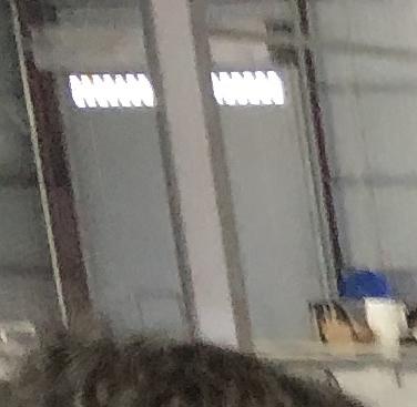

The fully integrated system was successfully tested on 6mm and 8mm thick welded steel plates with artificial flaws in UniKL-MIMET. It was able to track the weld with the guide system and acquired the data for analysis.  The location system was also used to track the vehicle’s path and display its posture.
The live inspection at UniKL-MIMET

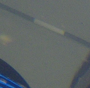

The inspection system operating underwater on a vertical plate
