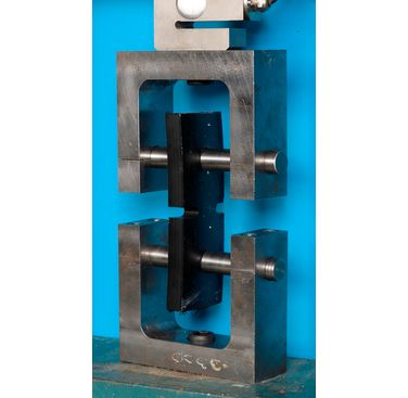

Previous Core Research Programme projects have shown that a tensile test using a reduced section specimen (Figure 1) is the most discriminating mechanical test for assessing the short-term integrity of butt fusion (BF) welds in high density polyethylene (HDPE) pipes. This type of test is specified in a number of standards, including EN 12814-7, relating to the qualification of BF welding procedures and welding operators for HDPE pipes. Most of these standards specify that the fracture surfaces of the tested specimen should be examined and categorised as being either ductile (large-scale deformation of material at the weld interface) or brittle (little or no large-scale deformation of material at the weld interface). However, previous Core Research Programme projects have also shown that the most discriminating test parameter is not the failure mode, which is subjective, but the energy to break the specimen, which is quantifiable.

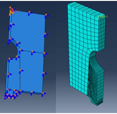

Firstly, tensile tests were carried out on specimens cut from unwelded sheets of HDPE, where the specimen geometry parameters were varied based on a DoE approach. Secondly, the stress field in the specimen was modelled during the tensile test using FEA for different geometry parameters (Figure 2).

Figure 1. Photograph of a tensile test on a reduced section specimens according to EN 12814-7
Figure 2. FEA boundary conditions and meshing size used to determine the effect of width of the waisted section, and loading hole diameter, on the elongation in the loading holes

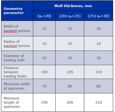

The results of the DoE and FEA studies predicted three modified specimen geometries, depending on their thickness (Table 1).

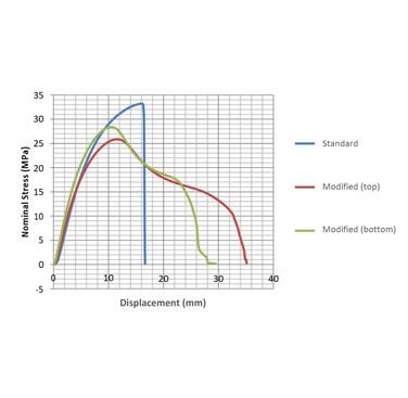

For BF joints with a pipe wall thickness greater than 20mm, the modified specimen geometry significantly increased the ductility and energy to break per unit cross-sectional area compared to the specimen geometry specified in EN 12814-7 (Figure 3).
Although the modified geometry for specimens from BF joints with wall thicknesses below 20mm did not improve the ductility, it significantly reduced the elongation in the loading holes and therefore resulted in a more representative value of energy to break per unit CSA without the need for an extensometer.

This work has resulted in proposed new specimen geometries and a recommendation that the maximum thickness of a specimen should be 30mm. For pipe wall thicknesses greater than 30mm, the specimens should be cut equally into two or more layers such that the maximum thickness of any specimen is 30mm.
The results of tensile tests on the proposed modified specimen geometries, machined from good quality BF joints in HDPE pipes with different outside diameters and wall thicknesses, have shown that the failure is always ductile for all thicknesses.
Table 1. Dimensions (in mm) for the modified geometry of the reduced section tensile test specimen
Figure 3. Examples of nominal stress vs displacement curves for the standard specimen geometry (EN 12814-7), and the modified specimen geometries for BF joints in 500mm SDR11 HDPE pipes (full thickness specimen cut in half to produce two specimens)
