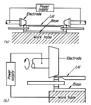

There are two types of seam sealing machine suitable for the hermetic sealing of electronic packages commercially available. These machines operate in what is classified as either a series or opposed wheel mode. In the series wheel mode, Fig.2a, the package and lid to be sealed are passed under a pair of small tapered copper electrode wheels. The transformer (power supply) produces a series of energy pulses (1kHz a.c.) which are conducted from one electrode across the package lid to the other electrode. The generation of heat at the wheel/lid interface is conducted to the lid/package interface to form either a weld or braze type seal, the nickel or gold plating acting as the brazing medium.
Fig.2. Arrangement of electrode wheel and current connections for the two available seam sealing equipments: a) series electrode wheel mode b) opposed electrode wheel mode
An alternative to series wheel mode is the opposed electrode mode, Fig.2b. Here again the package to be sealed is moved under a pair of larger electrode wheels. The power supply produces a series of welding pulses (normally d.c. capacitor discharge) which pass from the electrode wheel across the lid/package sidewall interface and return via the work table, generating heat at the electrode/lid interface and the lid/package sidewall interface. It is a common practice to have a power supply connected to each wheel. As can be seen from Fig.3a, a line of braze is formed between the package sidewall and the lid. The continuous seal which extends the full length of the package wall is formed by a series of overlapping spots (energy pulses) as the package is moved under the electrode wheels. At the end of each seam the package rotates through 90° and the other two sides are sealed. A plan view, Fig.3b, of the edge of the lid on a typical package shows the appearance of these overlapping spots. The weld/braze pitch, or the distance between consecutive spots, can be varied to control the amount of overlap.
