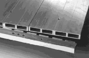

In the shipbuilding industry several companies use the FSW process for the production of large aluminium panels, which are made from aluminium extrusions. Commercial FSW machines are now available and include complete installations to weld up to 16m lengths. Currently 171 organisations hold non-exclusive licences from TWI to use the process. Most of these licensees are industrial companies, who exploit the FSW process in commercial production in Japan, USA,China, Europe and Scandinavia.
Fig.1. Marine Aluminium's prefabricated FSW deck panels for 'The World' cruise ship
Fig.2. Fosen Mek's cruise ship 'The World' contains friction stir welded decks
