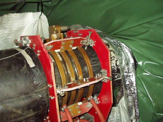

Low voltage electrical resistance heating uses flexible ceramic heating elements, colloquially known as corsets, an appropriate number being assembled to cover the area to be heat treated. Induction heating uses insulated cables that can be wrapped around the joint or shaped to fit the area to be heated or specially designed fitting for repetitive PWHT operations as illustrated in Fig 1. To perform the PWHT, temperature control thermocouples are firstly attached, often by capacitor discharge welding, the elements placed in position and the area then lagged with thermal insulating blankets to reduce heat loss and to maintain an acceptable temperature gradient.

Figure 1: Induction PWHT of Pipework
Fig 1. Induction PWHT of Pipework
