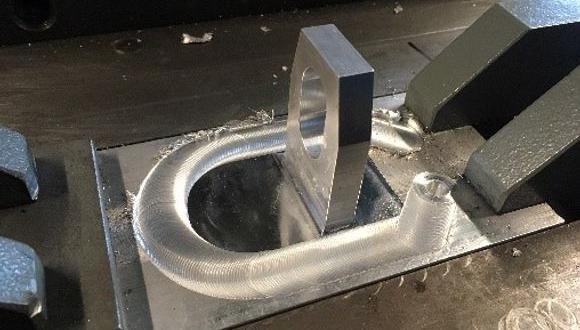

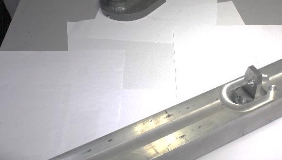

TWI has partnered with EIA University in Medellín, Colombia to introduce friction stir welding (FSW) to the Colombian manufacturing industry. The team successfully designed and manufactured a friction stir welded aluminium component for a door actuator in a rail car.
The original part, produced by arc welding, was prone to fatigue failure, causing significant disruption to the Metro network. The redesigned FSW part has been in operation for six months and will serve as a demonstrator for the wider adoption of FSW in Colombia.
As part of the collaboration, TWI hosted a researcher from EIA University for six months for joint research, providing access to TWI’s FSW equipment for the component development trials. The results were shared through workshops with local manufacturing and welding businesses with the aim of introducing FSW as a complementary technology to existing arc welding and machining methods.

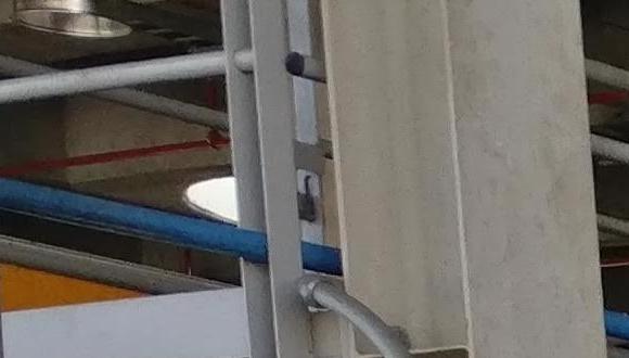

TWI Project Leader Dr Jeroen De Backer with the project partners on a site visit to the maintenance facility of Metro De Medellín.
