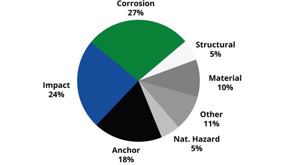

What are the biggest risks to subsea structures? Third party threats (such as impact or anchoring) and corrosion (internal and external) constitute nearly 70% of risk factors associated with subsea structure operation.
Inspection and maintenance are critical to avoiding failures. For deep-water applications. This has led to increasing deployment of UUVs (Unmanned Underwater Vehicles).

Risk factors associated with subsea structure operation.
