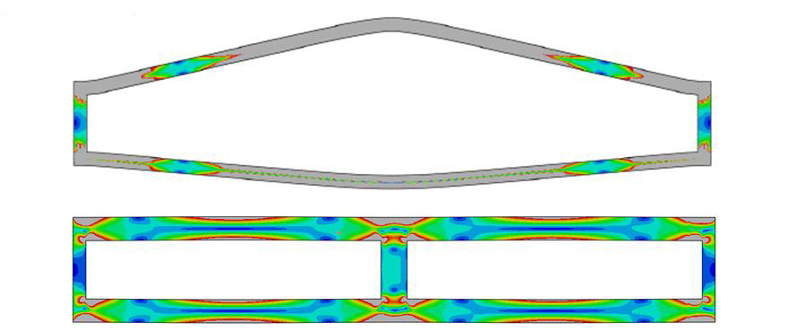

  • Design for manufacture: multiple finite element (FE) models were constructed to analyse the thermo-mechanical stresses of the hot heat exchanger (component with highest risk) in order to inform component design and integrity.
  • Advising optimum joining methodologies for joints within the TAG, to ensure joint integrity.
TWI optimised the heat exchanger channel design, achieving a balance between heat transfer, unit size and material cost. TWI’s analysis avoided plastic collapse of the narrow channels carrying working gas (helium) and exhaust gas at high pressure, with large thermal differentials. A 2D FE model demonstrated that adding a central support to the high-pressure channel, along with increasing the ligament thickness, ensured the integrity of the channels. Figure 1 shows the yielded material of the original channel design under pressure, compared with the new design, where through-wall yielding does not occur.

Figure 1a (top): Original helium channel design. Figure 1b (bottom): Re-designed channel. Grey material has yielded.
