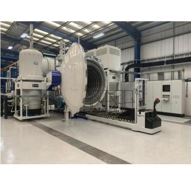

- ‘Adv-Flow’ Mass Flow Meter Project
This Innovate UK-funded project, ‘Development of Advanced, Highly Corrosion Resistant Coriolis Mass Flow Meters (Adv-Flow),’ saw TWI partner with KROHNE Limited and Langley Alloys to investigate advancements in the manufacture of large size Coriolis mass flow meters to meet demanding conditions for KROHNE, with a focus on the development of a suitable manufacturing route to manufacture the flow meters from super duplex stainless steel. TWI’s experts led activities related to heat treatment, vacuum brazing and characterisation (Figure 1). The key project objective was to achieve a sound joint whilst being able to retain the corrosion resistance and mechanical properties of the base materials.

Figure 1. Adv-Flow project

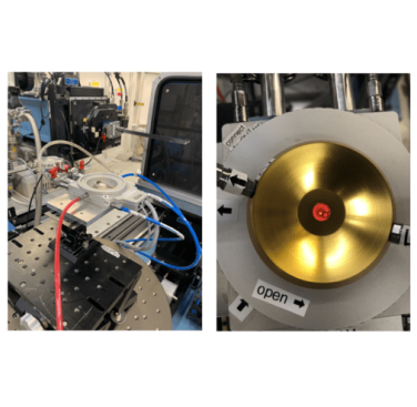

Figure 2. Synchrotron X-ray experimental setup. Linkam furnace apparatus (left), sample during brazing cycle (right)
