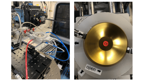

As part of the project, different HEA BFMs have been already developed for Ni-based alloy 718 and Cu-based alloy substrates; brazing process parameters were down-selected and the as-brazed microstructure was assessed. Additionally, several commercially available BFMs were brazed and the microstructure was compared with the HEA BFMs. This is also accompanied by advanced in-situ characterisation of the braze joint performed using synchrotron X-ray technique at Diamond Light Source (Figure 1).
Figure 1. Synchrotron X-ray experimental setup. Linkam furnace apparatus (left), sample during brazing cycle (right)
The project is now focusing on the investigation of synchrotron X-ray results and the evaluation and the comparison of the mechanical properties for commercially available and new HEA BFMs used in brazed joints.
